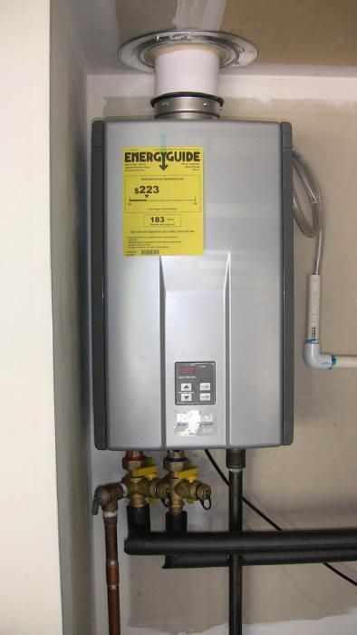

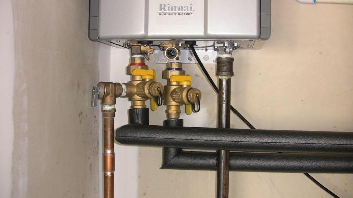

I installed a Rinnai RLS75i natural gas unit at the end of July. I have finally received my first gas bill with the whole billing cycle with the tankless.
September 07 Bill: 16 therms billed.
September 08 Bill (Aug 13 to Sept 12): 12 therms billed.
12 / 16 = 0.75
Or, a 25% savings.
I would think as the weather gets colder, the savings would continue.
I do have a major hot water use this year that I did not have last year however that may skew things a little. My wife is 37 weeks in her pregnancy. Sometimes she literally takes 3 baths in a day. It helps her with the pain. Even with that I still was able to get a 25% savings.
As far as the experience goes ... pretty typical of other tankless units I think.
I can run two showers without a hitch. I do not notice any fluctuation in temperature at all. I think the tankless does a really good job of keeping the temperature the same regardless of the load. Temperature consistency has been great. Don't notice cold "sandwiches" during use at all.
There has been a time or two where I have run into low flow situations where the flow was too low for it to kick in.
Getting ready in the morning is great. Back with the tank, usually by the end of the 3rd shower we were out of hot water. That was tough when you have at times 6 people that need showers and baths. We typically would have 2 or three people shower, wait 30 minutes to an hour, followed by the rest. Now, we just shower. The hot water heater no longer runs our life. I would definitely recommend a tankless if you have a large family.
Also, back with a tank, when another person started to shower in the other shower, you would also have to "fight" for your share of the hot water by upping the hot water every minute or two until you were done or ran out of hot water. Now, when someone jumps in the other shower, I do nothing but shower. The temperature of my shower stays the same with the tankless. It is really nice.
Obviously seek a plumber to see if a tankless application is possible.
Edit:
I had a 50 gallon "basic" natural gas tank prior. Nothing fancy, no special venting, etc. It was 8 years old when I replaced it. It still was working fine enough and probably could have lasted another 8 (who knows). As a family though, we were just tired of living as the water heater "told us" and so I decided to "convert".
And so, the big bang for me is the continuous hot water. The additional savings is just icing on the cake.
Some pictures:

Gas can be more efficient and it is also a cleaner fuel. Yours with the PVC vent is probably a condensing unit, which is even more efficient. Those are nice because you can route the vent almost anywhere, not so with a fuel oil vent. I went through this exercise a while back with propane (LNG) and found that it takes 1.4 gallons of propane has the same BTU as 1 gallon of #2 Fuel oil. Back then I chose oil over delivered propane but I'm not sure that the numbers would work out the same way today.

Mine is not a condensing unit. Those are rated something like 0.95, but are super expensive. This cost of my unit including installation, is probably around the starting price of just the condensing unit itself, not including installation. My Rinnai R75LS natural gas unit is rated 0.82. I might get payback on my unit within 10 - 15 years or so. It is too early really to project though - could be more - could be less. I would never get payback on a condensing unit before it died. The general life expectancy of tankless units appears to be 20 years. Maybe by the time mine dies, the condensing units will be the norm and really cheap.

Thanks for your report, and very nice looking install! It it interesting to see how your condensate drain was plumbed as well.
Also, I saw from looking the specs of your unit that it is 180k BTU max power. Mine is good for two simultaneous shower with very cold incoming water temp (about 10 degrees above freezing) and it's pretty close 200k BTU max power rating as yours. I bet you'll be fine in the winter, but it's always good to hear some additional data points!
My furnace is just down the wall where it has its condensate plumbing. The installers simply branched off of that piping up to my tankless.
Yes, this winter will be interesting ... the specs say I should be okay. It is good to hear your report of two showers. One contractor I spoke too, did not hire him for other reasons, was very informative. He stated that they were finding that the lowest gpm range for this area seemed to range from about 4.6 gpm to 5.5 gpm throughout the year. According to this calculator (select Flow VS Ignition) at 4.6 I should be able to handle two 2.5 gpm showers even if my water temperature is 40 F. Barely though, and there may be other factors that will kick in. Time will tell ...

The reason I ask about water hardness is because it will cause your heater to loose efficiency over time.
If You call the water department they should be able to tell you.
TheOak
Idaho
Sure it will ... just like it would a tank ... that is why it is recommended that it be flushed ... same with a tank.
