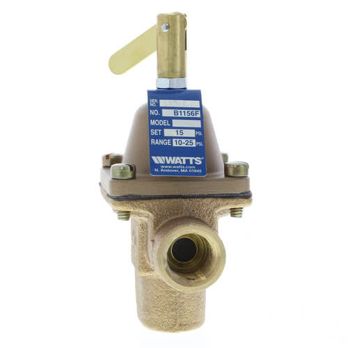

I don't see where the potable water is fed into the system in that picture.
Aut0-fill valves for filling the system are adjustable, and limit the pressure of the fill water to a lower pressure than the potable line pressure, which is quite a bit higher than you need or want for most heating systems. There are variations on the theme, but they look generally like this:
In MA they will also have a check valve to keep system water from backfeeding into the potable plumbing.
Find the model number on yours, and look up the instructions on how to adjust it online, if you can't figure it out by looking at it. Hopefully there is a temperature gauge nearby where you can eyeball it while adjusting it. (Can your Navien display system pressure?)

The auto-fill valve is the thing with the blue tag on it, that has the flip-lever and has an adjustment screw. The tag tells you the model name and the pre-set pressure it was set to at the factory, and it's adjustment range:
Note, the one in the picture was pre-set to 15 psi, which is fine for most systems, but may not be high enough for yours, due to the higher than average vertical distance between the fill-valve and your upstairs air handler. See the short-sheet installation guide for how to adjust it. You really need to take careful measurements and come up with the vertical distance, not a WAG. You can install a temporary pressure gauge onto the hose connection you have been using for purging the system. (Box stores often have pressure gauges designed for 3/4" hose connections- try to get something with a max of 100 psi or less for this job- under 50 psi would be even better.)
