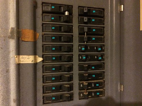

I have purchased a new 200A service panel (Square D QO 40 space) to replace my existing 100A panel, which is also in the garage in the back corner. That old panel is a Square D. It's really old. It looks like it belongs on a model T. Here's a picture, with the amps of the breakers labelled:

Q2: My existing WWII-aged panel looks like it's way over loaded. If I add up all those breakers, it adds to, like, 410 amps. Why doesn't my house burn down? I don't have breakers tripping all the time. Since there's no room on the panel for me to add a new breaker to power this new sub-panel, am I forced to upgrade this panel before I can think about the sub-panel?
Each breaker protects its own circuit from overload, then the main breaker protects the incoming line from being overdrawn. So, the total sum of all circuit breakers is not a primary factor unless you might somehow manage to have all circuits running at full capacity all at once. In my case, I had 60-amp feed wire from the pole coming into a very-old 60amp panel (containing breakers totaling 180 amps) plus a couple of sub-panels adding up to an additional 170 amps...and all of that means there were definitely times when my total load was more than 60 amps. That was not good, of course, but the previous homeowner had been allowed to do his own work and the inspector (as I discovered for myself) does barely more than a drive-by to mark his approval.

Is that existing 100A panel your main? If so, what do you have at the meter? You'll need new feeders from the meter if that is your main.

Your existing panel has some piggyback breakers in it already. Am not sure what's on the other 20 amp single pole breakers, but you might be able to add two more piggy backs and add a new 2 pole 30 amp breaker to the existing panel. I'd likely install a 220 volt outlet for the circuit. Won't get you where you really want to be, but it might scratch the itch to use your saw. Good Luck! Be careful!

suppose I just add the sub-panel?
Suppose I just do the following:
1.) pull the appropriate wire for a 100amp sub panel.
2.) install a 100amp breaker inside my existing 100amp panel by doubling up enough breakers in the main panel to make room.
3.) install one 30 amp breaker in the sub panel to power the saw.
Would that work? In other words, not doing all the work all at once, but taking little steps which are appropriate to get me there. The only concern I have is in adding a 100amp breaker to a 100amp service panel. Seems like somebody would call bullshit in some inspection.

I'm not 100% positive, but I suspect that the 30 amp two pole breaker could be used in the new subpanel when you ready to make the big switch. Recommend you do this top down, beginning with the main electrical service. Be careful of shared neutrals if you add piggybacks. You can't share a neutral on the same phase. Phases alternate top to bottom 1&2 on black, 3&4 on red, 5&6 on black, 7&8 on red, etc. GL
