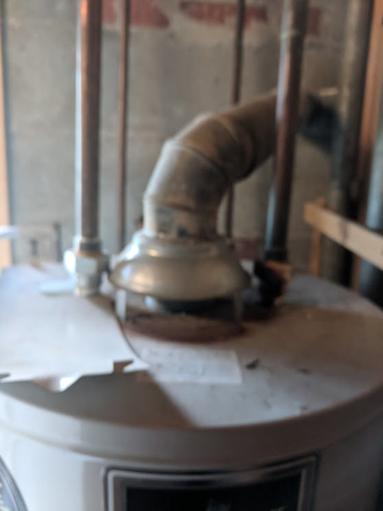

Hi all
I just bought a home and the water heater is going to need to be replaced soon. It is 11 years old and it was not installed with dielectric unions causing heavy corrosion on the water fittings and some on the top of the heater tank. I am pretty good with plumbing. I am also a chemist and work a lot with gas lines though I am used to Swagelok and other compression fittings. I live in stupid Illinois which code requires all rigid connections so I can't use the yellow flex line.
How do you work with black pipe that is threaded on both ends. I assume you can't loosen it on one fitting without tightening on the other so you need to find a union with a compression fitting and take it apart from there then once it is free from the union you can unscrew the whole set from the water heater? Is that right? Also I naturally don't have the cutting and threading tools so can I go to the hardware store and ask them to cut and thread the pipe to length if I end up having to alter the gas pipe length? Any tips on lifting the big old heater alone?

It's not possible to assemble it with all threaded connections without a union somewhere on the path, so find it. I may involve disassembling quite a bit of gas plumbing though, depending on just how stingy they were in the original installation.
Even though you are experienced, many states don't allow un-bonded non-licensed uncertified people to work on gas lines, so a completed DIY on this may put you at some liability if something ever goes wrong with it. Check your local regulations on that.
An old water heater full of lime deposits can be quite hefty. It's sometimes necessary to cut them up with an abrasive saw to get it out, or drag it out with a block & tackle.
The corrosion on the top of the tank looks more like backdrafting/condensation damage than galvanic corrosion. The union in the picture looks like it IS a dielectric union, with a plastic sleeve between the sweat copper and the outer compression ring that extends around to the mating surface.

I just looked it up and agree. It has a quick elbow turn there. Perhaps I should buy a shorter heater when it fails so I can put a vertical section before the elbow.

So it is probably more an HVAC/duct issue than plumbing the question is does the corrosion due to backdraft compromise the heater or is that corrosion on the exterior of the tank that shouldn't compromise the the lifespan too much if I have the backdrafting corrected? 11 years isn't too old I had a heater fail on the family home I sold earlier this year replaced at ~25 years of age.

I don't know about the life of the heater being affected, but I doubt the draft issue would be solved by adding inches of vertical rise via a shorter water heater. It's more likely that you've got issues with the rest of the vent stack. There are a couple common issues to look for.
First, was this water heater orphaned -- ie. did it used to share a larger vent stack with another appliance that is now gone? (typically a natural draft furnace/boiler that got replaced by a high efficiency direct-vent unit). If so then your vent is almost definitely oversized for just the water heater.
Second, if this vent goes into a masonry chimney, is the flue lined with an appropriately sized liner? If not this can make flue gas spillage likely at the water heater.
It's hard to tell from your picture how long the vertical section of vent is, but if it's just a short jog of a foot or two then it's pretty unlikely to be a problem.

According to the inspection report if anything the water heater is over vented.

The vent does need to be properly sized -- oversized is bad. The vent flue relies on a sufficient amount of heat in the stack to cause an upward draft. Your water heater's burner is too small to keep the stack properly heated, and so the upward draft is poor. It can even back-draft, typically during windy conditions and more so in the winter than the summer.
Back when there was a furnace sharing the vent, there was plenty of heat from 2 appliances to keep the draft strong. Not so, anymore. This is the "orphaned" water heater scenario mentioned above and is likely the cause of the flue gas spillage that is making the top of your water heater corrode.
In addition to making acidic condensation on the top of your water heater (which is causing the rust), the back draft is also spilling carbon monoxide into your living area. I don't mean to alarm you, the amounts are typically small and your carbon monoxide alarm would alert you to any dangerous situation. (you do have one right? if not you should buy one ASAP)! But this is something that should be addressed.
To fix this problem correctly, you need to do one of two things.
Option #1 is to get the vent sized reduced down all the way up through the roof, either by having a correctly sized liner installed (if this is a masonry chimney) or ripping out the old Type-B Gas Vent stack and installing new, smaller one.
Option #2 is to install a direct-vent water heater (that goes out the side wall), and cap off this vent stack.

Indeed I went over the report and the water heater is now orphaned looks like the HE furnace install was a couple years ago. Not sure what the best option is. sounds like liner would run ~$2-4k, direct vent water heater ~$2k, might as well consider tankless.

Don't rush into a decision, take your time. Make sure you have working carbon monoxide detectors in the house at all times just in case, but this is a somewhat common problem with natural draft water heaters and it doesn't typically cause an immediate health hazard except in severe cases.

Thanks for all the advice. I made an appointment with a chimney sweeper to install a 4" liner to correct the issue. It is only ~$6-700. Is there anything I can do to treat the corroded areas of the tank? I see no reason to replace it until it shows signs of being structurally compromised from the inside or stops functioning. Like I said my last tank lasted well over 20 years.
I wouldn't worry about it, the rust you are seeing is on the outside casing. Underneath that casing is a layer of insulation before you reach the surface of the actual water tank. So what you see there is cosmetic and not even on the water tank. The water connection fittings do have a little surface rust but that is no problem at all. You could hit them with a wire brush if you like things to look nice & shiny, but functionally it won't matter one bit.
