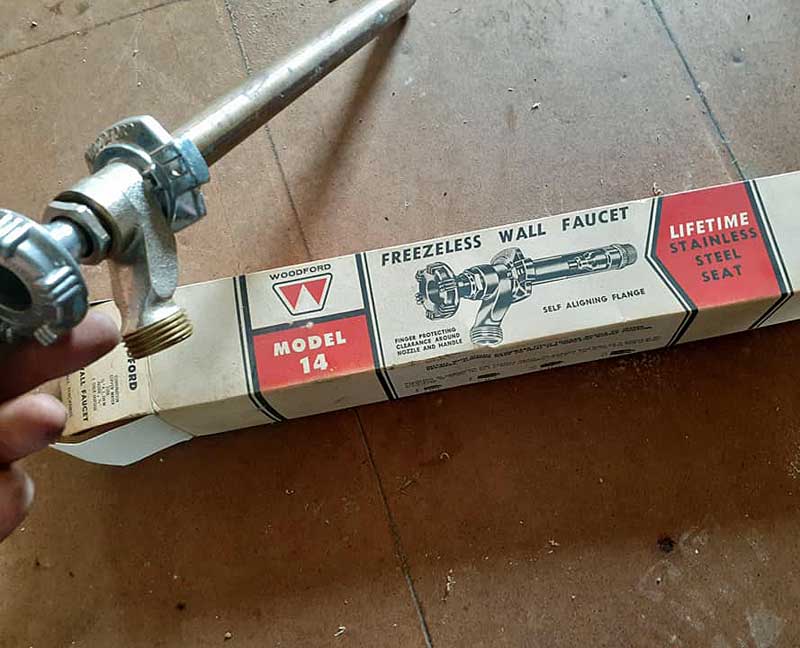

We're renting an older home and a couple of weeks ago, I went to hook up the hose to the spigot out front (after researching I think is a Woodford Model 14) and it wouldnt screw on. The threading on the nozzle appeared to be worn down on the side but after further inspection, it looks the same way on the other side. The threading on both sides is flat and I assumed that was what was preventing the hose from screwing on. We figured the previous tenants must've accidently took an adapter with them so I had the maintenance guy come out and he said he thought it might need a vacuum breaker or a backflow preventer (which I had never heard of before this ordeal) so based on pictures I saw online, I ordered a LASCO 05-1771 to give it a try... didn't fit. Finally, I went to a plumbing supply store and talked to a guy who's been in the business for 35 years and when I showed him pictures, he said he's never seen threading like that in all his years. He recommended I try two parts ("LF 3/4 BRS COUP" and "LF 3/4 MIP x 3/4 MHT BRS HOSE ADPT" - thats the description on the receipt. I haven't a clue what they are actually called). As expected, they didn't screw on either. Have a look and let me know what you think. At this point, I'm out of ideas on what we need to make this work. Before I campaign to have the rental company replace the entire spigot, figured I'd ask online to see if there are any ideas. Thanks for your help!

You could try dressing up the thread grooves with a small triangular file. It is not the threads that hold the water in.
However replacing the spigot might be easier depending what is on the end of that frost-free spigot.
3,482
If it were my home, I would replace the entire hosebib and be done with it.
Looking at it twice, I will also vote for, I have never seen threads like that before. It doesn't look like a hose would have ever threaded on those.

That "conical" end implies that whatever screwed on to those threads, probably a Woodford proprietary vacuum breaker, was NOT a run of the mill item. If it was for a hose or common hose vacuum breaker it would have a flat end for a washer to seal.

Is the thread about is 1.031 O.D. and have a pitch of 11.5 TPI?
I was thinking the same thing when I saw that. Everything I've found so far wouldn't make a tight seal with that type of end on it.
I think the female end of a hose should screw on the faucet. Make sure your hose coupling is not bent. It needs a good washer in the female end of the hose so it doesn't leak..... The adapter you bought is not going to fit.
If you want a vacuum breaker that attaches to that type faucet here is a link:
http://www.lowes.com/pd_21507-34146-MVB+3/4_0__?productId=3353894
I've tried three hoses and one of those adapters that allow you to angle the nozzle out for the hose to screw on. Plus the vacuum breaker I bought and the piece I bought at the plumbing supply store yesterday (model numbers in the OP) and nothing will screw on.
That VB you linked to from lowes is one that I looked at. It has a different threading and it looks to the untrained eye just like the one I bought that did not work.
I give up, I'm just going to get the owner to replace it. Glad ithere are professionals that are just as perplexed as I am. Thank you everyone for your input.

1.031 is a little over an inch. O.D. is outside diameter. TPI is threads per inch. At 11.5 TPI, the distance from the middle of the top thread to the middle of the bottom thread would measure just over 1/4 inch.
Those measurements are for a typical garden hose thread.

It appears he has already tried SEVERAL "typical hose threads" and they did not work.

My theory was that somebody had mutilated the threads to prevent hose attachment. This could have been a method of working around the requirement of a vacuum breaker to satisfy an inspector.
Of course I could be way off. I am thinking that if the diameter was much different from the standard GH thread, jbnc would have probably stated that. I don't have a theory on why a GH connection would have that shape on the tip, but if the thread fit, it looks as if there would be enough surface to seal effectively against a garden hose washer.

My guess is the threads were mashed my the set screw of an add-on vacuum breaker & over the years the VB also damaged the end of the hose thread connection. Regardless, if a hose won't connect the only long-term solution is to replace the entire unit.
