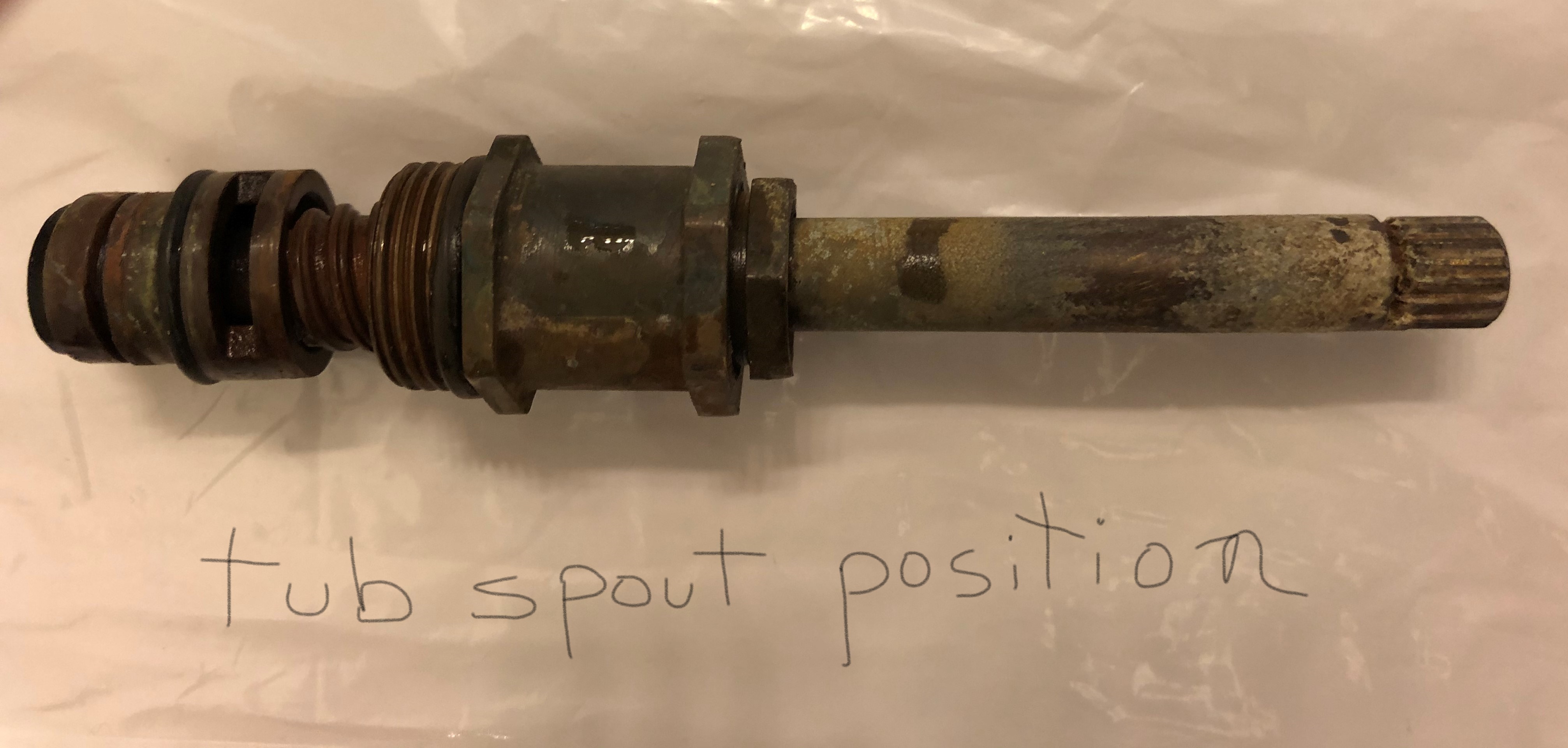

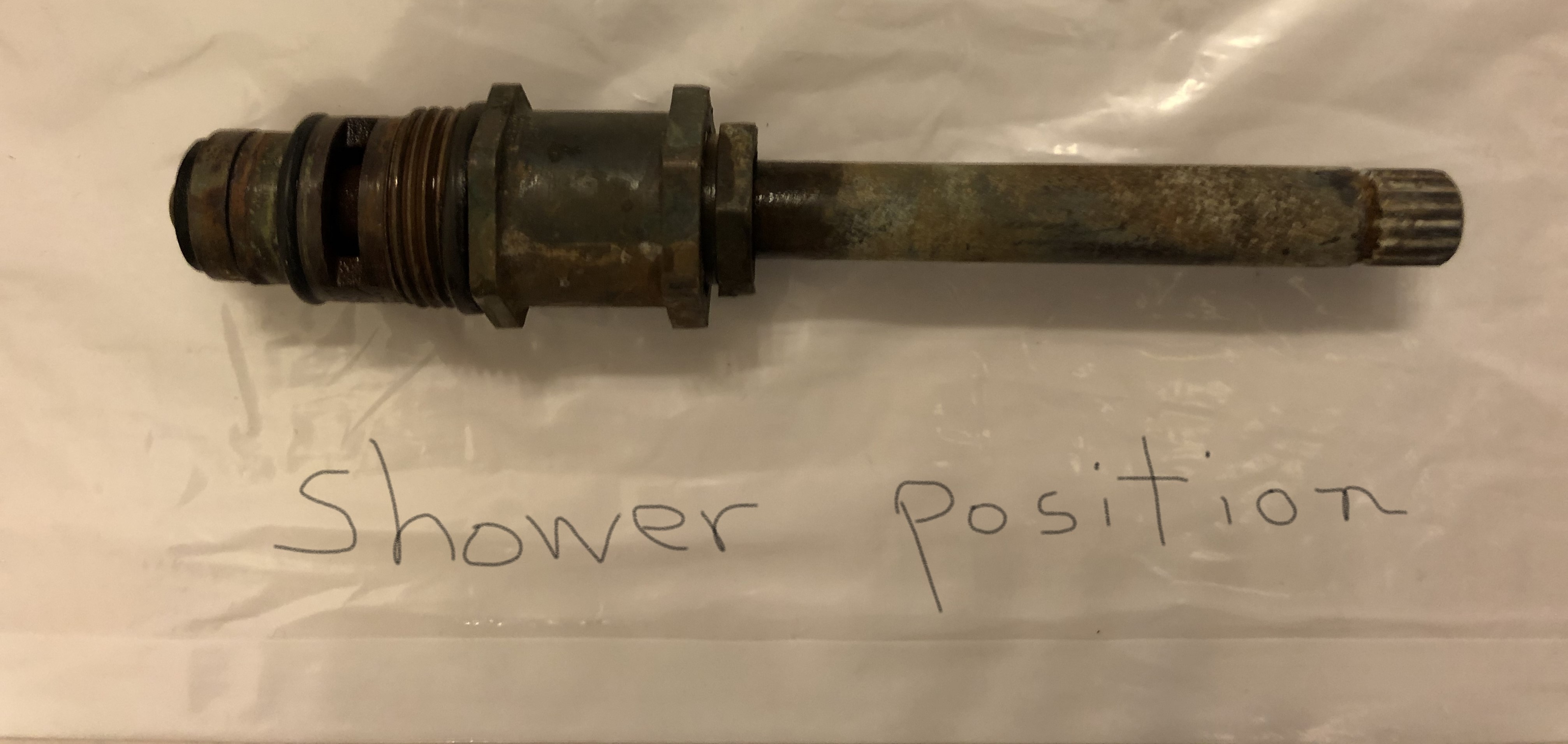

When shower is on I am getting a small steady stream of water from tub spout.
yeto
SC
When shower is on I am getting a small steady stream of water from tub spout. What part of the diverter valve needs to be repaired to prevent this from happening?
Thank you in advance for any help,

It is easier to just replace the diverter stem. Replacements are fairly easy to get. You just match it to the one you need and screw it in. Easy peasy go have fun.

You have 3 pieces of rubber there? Two o-rings and one washer on the end? You could try replacing those 3 with the help of a good hardware store. I am not a pro.

When in the shower position where is the water traveling to get to the tub spout? Is it the "cage" that is worn that is allowing the water to pass?
