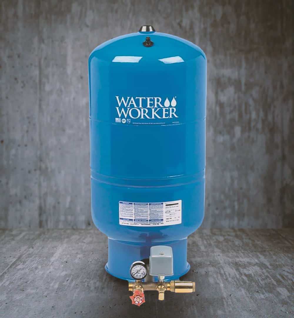

OK, I see what you've got there. Yes, you can use the existing plumbing but as long as you're changing the tank, I'd clean up the piping as well. What I would is add a new manifold to the new tank in order to clean up the piping along the floor.
This manifold threads right into the bottom of the tank and sticks out the front where you add the pressure switch and its standpipe (clean that pipe out if you reuse it!!), the gauge, the pressure relief valve, and the hose bib to drain it. All you need is your in and out pipes to the sides of the manifold. The good thing is that even Home Depot carries them if someone kicks it and damages it (that happened to me).
