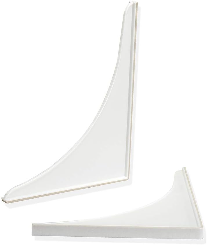

In 2017 we installed a new non-metal tub and surround. Everything was installed as it should be but the water hits the lower lip of the surround in the front and then water dribbles / runs along the front top portion of the tub. Ending up on the floor. We solved this by placing suction cups along the vertical edge of the surround and clamped in the inside curtain. Last Thursday a contractor for the insurance company came to do an estimate (filing a claim). He grabbed the front of the shower curtain and flung it back, tearing the inside waterproof curtain out of the suction cups. Now I can't get it back and make it happy so it doesn't leak. Why the "heck" didn't he open it from the back, it was already open two feet.
After the install and the problems, I took videos and sent to the tub manufacturer. They gave me credit for the tub purchase but the cost of the tub was the least expense in the project.
When this all started we looked at other tubs and there were tubs out there with a small lip on the outside top edge of the tub and to me, the reason was to keep water from spilling out onto the floor. Not everybody wants a shower door. Yeah a door would stop all of this problem.
Now that I may have to do another install (insurance claim) I started looking for tubs with that lip. I can't see any. I was by my cousins house and it is an older house, she has a lip on her tub, just as I described.
Can I still find such tubs or do the manufacturers expect everyone to install shower doors? If so errrr! So many things these days are made in one way and one way only, options are few.

My first home built new, 1979, the entire neighborhood had the same problem with newly release fiber glass type tubs. The fix was the splash guards.
To use suction cups again, the old ones get hard and won’t hold a suction. First is clean the wall they were on with CLR and uses a blue scrub pad (not green). Wipe it down with alcohol. Buy new suction cups and it should be able to work as you had it.

I did order splash guards one time but it never sealed well at the 90 degree part.
This really is a problem of engineering and design. Hm? A weep hole at the front of the tub that exits into the drain over flow piping. Didn't Sterling tubs have some sort of weep hole for water to return to the tub? Maybe it was a different issue. Build them like an airplane with redundancy built into the system and leaks out of that front edge would be gone. Just a slight slope at that front would stop an amazing amount of water from getting past the inside liner. But that would be done during the mold of the tub.
