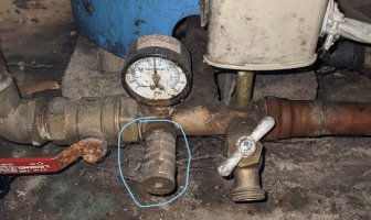

Since moving into my house in January 2018 we have been plagued by this occasional banging noise in the pipes when water is shut off.
Looking online I see that it is probably water hammer or resonance, but any examples I have heard don't exactly sound the same.
What we get is either a rapid fire (maybe 4-6 per second) bangs that quickly diminish OR a repetitive slower (1-2 per second) bang that can last up to a minute (that's the longest I've let it go before turning on another faucet)
Couple key points:
This banging can happen from seemingly any faucet in the house
Most of the time I can get it to stop by turning on any faucet and VERY slowly turning it off, sometimes I have to do this multiple times in order to get it to stop
It seems to happen primarily from faucets, I've heard it from a toilet once or twice, but I've never heard it from a shower/tub or spigot
Happens on both hot and cold side, though seems primarily cold water (probably 85% cold and 15% hot)
I cannot see any hammer arresters or anything, though there is a gauge right next to the pump that doesn't really show anything when the banging happens as far as I can tell.
About the setup:
I have a well (250ft) with a 3/4HP pump that I just had to replace last year (this problem predates the replacement)
Original house built in 1986 (2 bed 2 bath)
Addition sometime in the mid to late 90s added another bath on the second floor
Garage addition sometime in the early 2000's added yet another bath upstairs.
The well pressure tank is just inside right before the gauge
The gauge has some sort of spigot attached to it (see attached pictures)
From the pump it goes:
Pump-->Tank-->Gauge-->Iron removal system --> rest of the house
One thing I found weird is that leading up to the Iron removal system it's a 1" pipe, then goes through the tank with 3/4" then back to 1" after the tank (though I'm assuming that's only because the Iron system was installed after).
Would adding a hammer arrester possibly fix the issue?
Anything else I can check?

1. The thing you drew the blue ring around is a pressure relief valve. Typically they release water when the pressure gets to be over 75 psi. The purpose is to save the pump and drop pipe if the pressure gauge were to get stuck on.
2. Putting a water hammer arrestor near the pressure tank will not help.

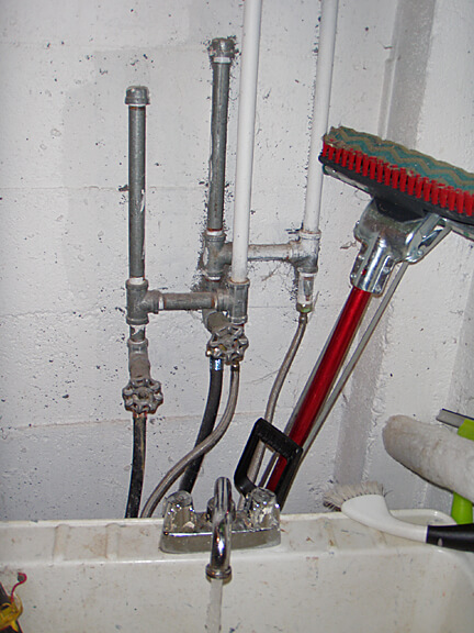

3. Your house may have old style water hammer arrestors that get waterlogged. Try turning off the water, and let it drain. Open faucets to admit air. How long to drain the water and admit air? overnight, or two hours, I would think.
4. While things are draining, and the water pressure is zero, that would be a good time to check and adjust your pressure tank air precharge. Typically, with a submersible pump, you set that to 2 psi below the cut-on pressure.
5. Drain from the drain valve in your picture. Note sediment. As part of your cleaning, turn on water, drain, turn on water, drain... until you don't get sediment. This is a regular maintenance thing. Typically annually, like checking air precharge, but if your well produces a lot of sediment, do it more often.

1. I figured it was something along those lines, thank you for clarifying.
2. I wasn't planning to place it there, just wondering if I should put one somewhere.
3. All I see in the basement is pipes, there are the typical bleeders and things near the boiler, but other than that nothing but pipes. What do the "old style" ones look like?
4. & 5. I will plan to drain sometime in the near future, as far as I know there is minimal to no sediment as I don't have a filter anywhere and have never seen any, but will plan to drain every couple years going forward

The vertical capped pipes are old water hammer arrestors, and they get waterlogged.
