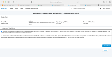

Just reached out to Uponor Warranty Claims <warrantyclaims@uponor.com> and am awaiting word.
Uponor has a website dedicated to warranty claims, which is suspect, but take a look at the very first question to begin the process (see the screenshot).
To which I read that as: option 1. send us the damaged section of pipe, which we'll test and probably destroy to prevent any future evidence for a lawsuit OR option 2. we'll conduct a visual inspection and most certainly deny your claim.
It doesn't instill confidence.

Ask them to provide in writing/email the exact amount of pipe that they need to "destroy" in order to determine if their pipe is bad...

Jessie Thanks for sharing useful info in understanding some of this some of the hystrical homeowners dont seem to get that just whinning isnt a help .
One thing is its at least partly understandable that a destructive test is done , however if they were determine that warranty wasent granted they damn sure oughta give back your property. secondly Uponors failure to figure out "root cause" dosent mean to me that thier failure to understand why it failed wouldnt absolve them from warranty in my ( not so legal ) opinion. its like saying we arent very smart we dont know why it failed so it must be someone elses fault.
Why not refuse to submit a sample and only after denial of claim thgen submit submit a sample?
I want Uponor to co operate and the homeowners and hate Lawyers involved .
Im wondering based on Uponors comment on finding root cause what they have been determining on other cases and why none of these I call Hysterical owners havent told us ? secret agreements maybe?
Any way Jess What would you really expect them to do with the samples ? better idea no testing of anything ? Im not sure

Yeah, you're true. I suspect they have to cya themselves too from fraudulent claims, etc. I've decided to continue down the path of sending them at least one failed section. I'm sure I'll have plenty more as the entire house is ripe for failure (I guess). But I'll take the advice of @JohnCT to inquire about specifics.
