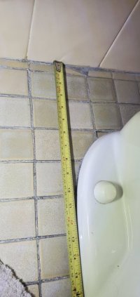

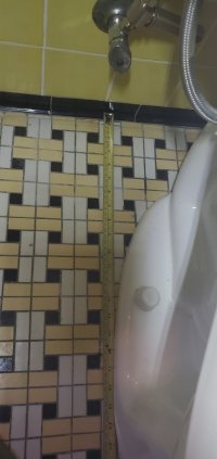

Hi,
I have an old American Standard Plebe which is over 30 years old (2 first pictures), with a 10.5 rough-in (I believe, please see picture and correct me if I am wrong). I would like to replace it eventually and wanted to confirm which rough-in size replacement toilet I should by, would only a 10 rough-in fit? The tank is against the wall, but the new toilets have about 1.5 inches of play behind the tank. But if my math is right, a 12 inch such as America Standard Sonoma will not fit??

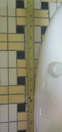

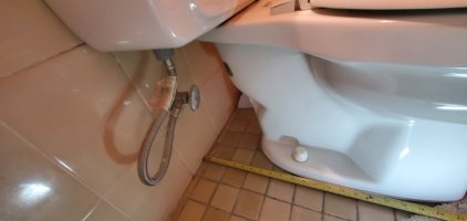

I had somebody install a American Standard Sonoma (2 last pictures) rough-in 12 inch in my other bathroom a few years ago, and I see it is 1 1/12 inches away from the wall. Since that toilet is a 13 inch rough-in, I am actually wondering if I bought the right toilet size for that space? And would this toilet fit to replace my American Standard Plebe 10.5 rough-in??
Thank you.
Newbie01.
It fits, so it works.

No, the toilet tank would bind against the wall. It looks like you need an American Standard Cadet or Colony two piece toilet with the associated 10" rough-in tank for each model. If you use the parametric search on the American Standard Canada website and check the 10" rough-in parameter it will show your options.

Greynold929, thank you for your answer. There is no other solution but the 10''? If that is the case, selection is limited and since I would kike to go with a known brand, it would appear American Standard Cadet 3 would be the choice.
How about my toilet with the 13'', did I make the right choice to buy a 12'', or would you suggest something else (such as 14''), as I have another bathroom with the same measurements. Thank you.

its not a 13 inch rough toilet its a 13 inch rough in for a toilet . 2 differant things.
Id say one should take a 12 and the other is a 10 or you might be able to fit a 12 I doubt it but if you cheat the bolts and possibly shim the bowl up in the rear you might get it to work . how about an offset ring?

You would need to get a 10 inch rough in toilet.
