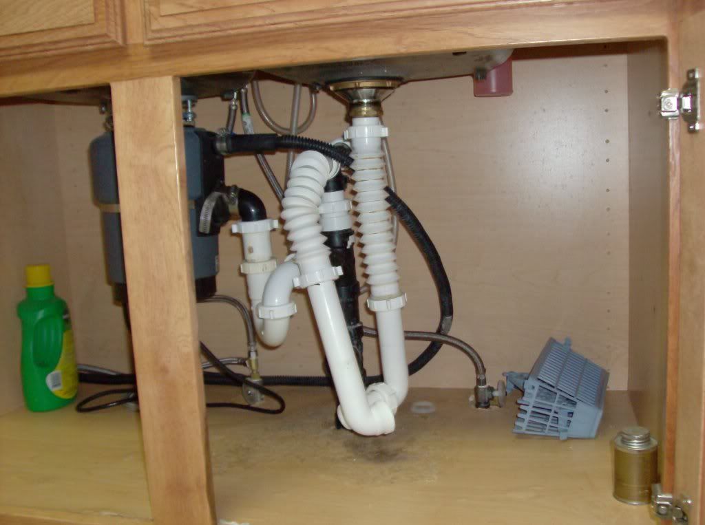

Here's a beauty I found last week:
Herk
545
S.E. Idaho
The dishwasher drain doesn't require an air gap here. It does, however, require a high loop and I fastened it to the bottom of the counter.
The reason I got the service call is because hubby is gone, the sheets are split, and the lady was trying to plunge the sink. She had filled the sink with dishwashing compound and then tried to plunge and the two corrugated pipes burst apart. Would have been fun to watch her scrambling to clean it up.
I should have taken a pic of the fix - basically hard piping the vent and using a disposer waste into a single trap. Unfortunately, the pipe going down still remains 1-1/2" but that's under concrete floor. I don't know if you can see it in the picture, but the drain comes up through the cabinet about a foot from the back wall.
