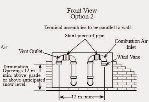

I have been reviewing the Rheem installation documents for their power vented units and I'm concerned that the guidelines limit the installation options considerably. The instructions (example) state:
"Elbows are limited to a total equivalent length of 20 ft. (6 m). Maximum allowed four (4) 90° elbows or eight (8) 45° elbows" [p. 13]
"A 90° elbow is equivalent to 5 ft. of straight pipe. A 45° elbow is equivalent to 2.5 ft. of straight pipe. The use of a 45° elbow is preferred over a 90° elbow. The vent and combustion air-inlet terminations are not included in the equivalency calculations." [p. 13]
"IMPORTANT: Remember to include the additional 90° elbows and vertical height of the vent and combustion air-inlet pipes of the vent riser when calculating the maximum equivalent vent and combustion air-inlet system lengths. The maximum equivalent vent and combustion air-inlet
system lengths must be as specified on page 13." [p. 17]​
I'm a little confused on the limitations placed on the total allowable elbows. 4 elbows max seem to be limiting in the installation. It seems like you more or less have to have a straight shot out the wall and running parallel to the joists to make this work.
In reviewing the literature on similar units from other manufacturer's they don't have the same limitations. Does the limitation only apply when using 2" PVC where you would quickly get to the max equivalent length with more than 4 elbows? Or does this apply to 3" as well, despite the equivalent lengths potentially being well under the max length?
Additionally, there appears to be some inconsistencies in whether the air inlet pipes are factored into the total system length. P.13 indicates they are not, while P. 17 indicates they are.
Should I ignore the guidelines for the max number of elbows and just rely on the calculated equivalent length? Should this include terminations or not?

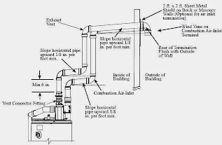

I have been giving this a lot of thought. My vent run inside the basement would look similar to the image on the left below. However, I may need to add 2-3 elbows depending on if I relocate the heater or not. So I would have 5-6 total elbows before I exit the basement. On the exterior side I would have another 3 for the terminal assembly to give me ground/snow clearance. The total elbows would need to be 8-9 for each run (+40-45 feet).
In looking at the layouts Rheem provides, they are showing as many as 6 elbows. However, according to @jadnashua not all of these count. Is that correct?

The documentation you provided says "The vent and combustion air-inlet terminations are not included in the equivalency calculations." IOW, those at the end of the run at the outside of the house do not count, but everything else does. To ensure you get the proper air flow and proper air mixture (required for proper combustion efficiency and CO production), you must have your system setup as originally designed. If you can't, you find a different unit, or move where it is installed, or change the run layouts.

Thanks. I must have been misreading as the two statements seemed to be contradicting one another. The latter statement must be referring to the vent riser coming off the water heater. Whereas the first statement must be just the termination I guess. So in the images I posted above I would count 3 elbows for the run, correct?

Based on the printed instructions you provided, yes...that example shows three countable elbows. That would count as 15', then, plus the actual lengths of the pipe must all be less than or equal to the maximum allowed.

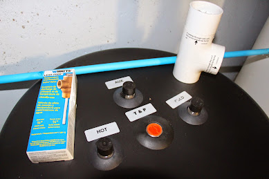

I ended up selecting the HTP Phoenix Light Duty PH76-50. Feature and spec-wise, the Phoenix seemed to beat the comparable Rheem and AO Smith. Also, I am hoping that the stainless tank extends the life well beyond the other two units providing less total expense over the life of the unit. I considered going tankless for a moment, but I think a tanked unit made more sense for me.
Anyway, Carr Supply dropped off the unit today so I thought I would share some pics:

Easily accessible mechanicals; behind sits a stainless steel tank wrapped in 2" of foam...
WfuF4pAnWtZbNMbDAQyOJVTPvVVL1USJUGIth8nyE-I=w173-h259-p-no
Connections include an auxiliary port if you want to add a hot water recirculation system or heat exchanger; includes a termination fitting for the intake...
9yqjHTz5lyVILzLW_NQYvXLHB7nS3WKkIzXbBjbPFyY=w389-h259-p-no

If you have the space, using two 45s rather than two 90s for the first two turns would be a better installation.
Is using two 45*'s in quick succession better than a 90* sweep? I'm having trouble finding a 2" sch 40 90 degree sweep (DWV are more common).
