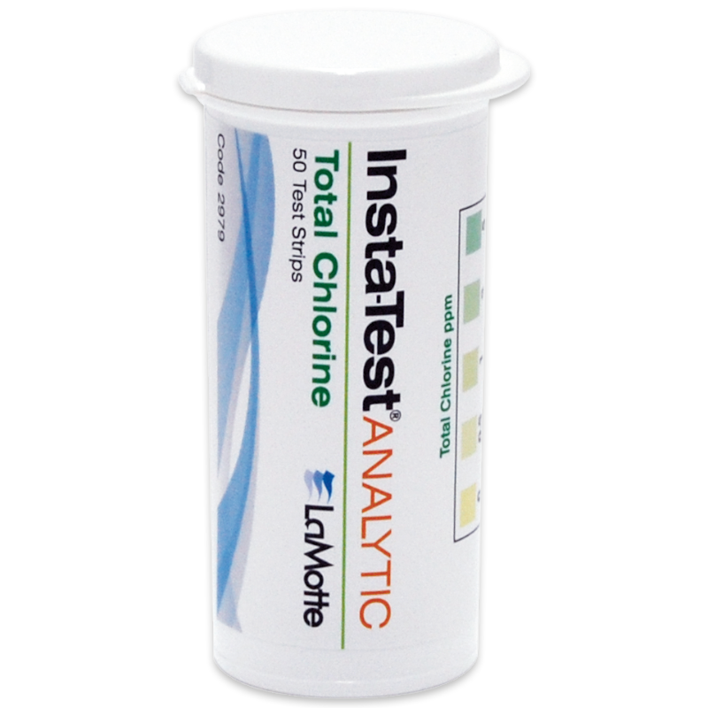

Good point on the distinction between GAC and catalytic carbon. I would get some low-range chlorine test strips to check residual chlorine/chloromine. I suspect the strips should test for total chlorine vs free chlorine, but I don't see that discussed.
If the chloramine/chlorine is being removed, the carbon is still good.
For low range testing, LAMOTTE 2963LR-G .25 ppm to 10 ppm chlorine
test sensitivity, looks good. 2979 is 0 to 5 ppm chlorine. (zoro)
https://www.zoro.com/search?q=LAMOTTE chlorine (many)
Your local pool store might have a suitable kit or test the sample you bring in. Ideally you will have a sample spigot (drain valve) between tanks.

Thank you for a good way to check if the carbon media is still functioning. I have a pool test kit at home and will do the testing. If it’s good then I’ll try to buy 5800SXT valve
