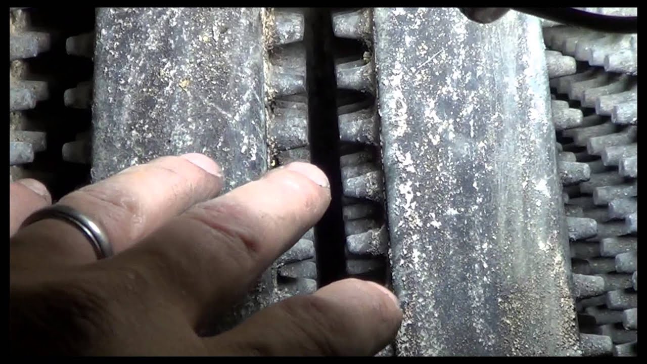

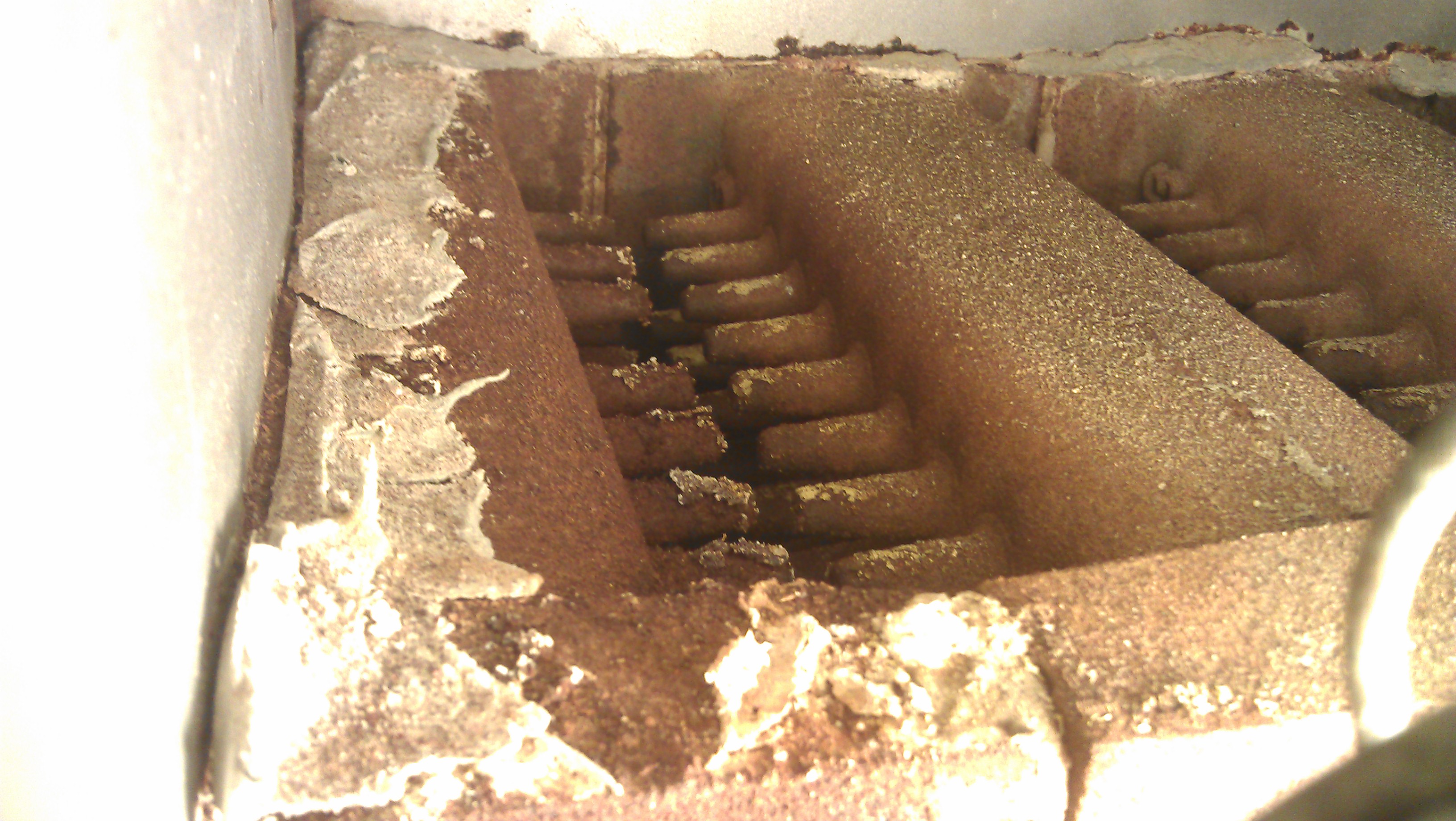

The condensation would only rarely be copious enough to drip down to the burner tubes, but the amount of corrosion on the fire side of the heat exchanger plates could be pretty high for a boiler it's age if condensing. It's not impossible for a boiler to be completely toast after 2 seasons if condensing copiously, but it's also not impossible for it to still be functional after 10 years (though the raw combustion efficiency would be well below the nameplate efficiency.) I haven't torn into a CGa-4 myself and can't say for sure, but the fire side of the plates are usually at least partially inspectable with a mirror from below without partially disassembling the jacket (which would be necessary to view it from the top.)
A typical cast iron boiler of this ilk would have plates that look like this on the fire side if burning cleanly without condensation:
If it has been condensing a lot those nipples creating the extra surface area and turbulence can sometimes be corroded down to pointy cones, and the overall appearance of the castings will be more pitted. (This particular picture is from the top, post cleaning, on a boiler that had sooted up.)
If there aren't any indication of bits of rust falling out onto the burners yours probably doesn't look anywhere near as bad as this:
But if it's been condensing it might look like this:
If it's satisfying calls for heat in under 10 minutes, rarely exceeding 120F and never actually hitting 180F, your system is an ideal candidate for a condensing boiler. Are you certain that there isn't already a boiler bypass or system bypass? Some pictures of the near-boiler plumbing could be useful. Putting the bypass-plumbing money into a right-sized condensing boiler might be the better investment if you plan to live there for another decade.
