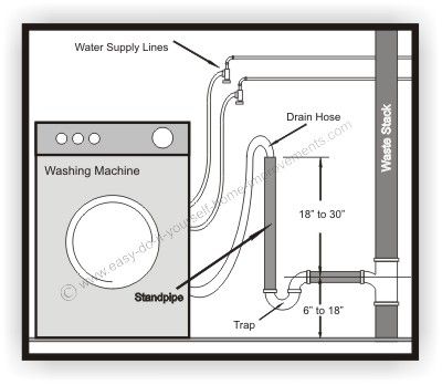

I have photoshop. I still can't draw very good. Is this the general idea? Add a three inch pipe to collect the sink/dishwasher in one wye, a second wye downstream/below for the standpipe. I know there are thick books of codes. Do you think venting the top of the 3 inch locally in the basement would be an issue? it is two stories with an attic.

I expected it was put there to add some storage capacity for stuff waiting to get thru the trap. This could have been after observing the kitchen sink getting water coming up when the washer emptied.
It's a bad install design. It does not come close to meeting codes for more than one reason. Some include
  1. two traps in series
  2. pump from wm pressurizing the sewage pipes
  3. no vent for the wm, tho your sketch would solve that.
  4. The upper left of your photo has a non-shield rubber coupler. That should be shielded (metal band around the rubber).
Your new design
  1. should have a p-trap at the kitchen sink. There may be one already, since your photo and diagram don't show that area.
  2. should have the kitchen waste join the waste pipe after the vents.
  3. should keep the pipe after the kitchen p-trap horizontal (1 inch/ft drop) until the vent. Instead of your new wye, you need a sanitary tee.
Maybe you could bring the kitchen waste into about where your rubber coupler is. What is that line that joins in right below the rubber coupler? I am not a plumber.

There is a p-trap under the kitchen sink. It comes into the basement as 1 1/2. I will increase that to 2" right below the floor joists and slope it 1" per foot to the other side of the house where it will meet the waste pipe.
