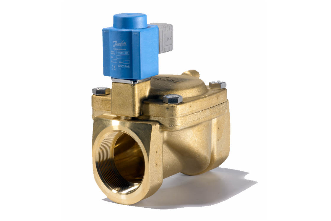

Solenoids being non potable water work differently and can have different elastomers that change the taste of the water. Here's a valve it doesn't have a direct lift.
Thanks for posting that. The point about the bacteria is something I hadn't thought about. Not sure it matters for hot water but I'll definitely think about it. Looks like the proper valves are around $100 each or a little more.
There is big difference between China and others.Go to their web site they have both portable and not it might be stainless.

The 4 loops 3/4" pex what are the lengths of each loop? Sol valves have 1 lb pressure drop @ 5 gpm 60 lbs
1 x 150 is the longest. 2 x 100 give or take, and 1 x about 50'. But each loop operates individually and more than one open at a time effectively never happens.
