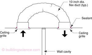

To meet current code when using stud bays as return paths it needs to have hard piped duct in the wall. There are 3.25" x 14" ducts (even at box stores) purpose-made for installing in 2x4 partition wall stud bays, as well as 3" x 10" - 3" x 14" ovals (which tend to be a bit quieter than rectangular duct). As with any duct system, seal all seams and joints on jump duct returns with duct mastic to reduce leakage & noise. For high cfm rooms it sometimes takes 2 (or even 3) stud bays to get there, but I'm guessing your supplies to those rooms are 6" rounds(?) or smaller, and a single ~3" x 14" jump duct would be plenty. Whatever the cross sectional area of the supply duct to the room is, as a total-hackery rule of thumb sizing the jump duct at 1.5x that cross sectional area or larger would still make it. (That's a LOT smaller than an open door, eh?)
If the ceiling joist bays are deep enough an 8-10" round can work with transfer grilles on the ceiling.
For jump ducts in joist bays it is better to use right angle duct boots or hard-piped ells right out of the duct boots and keep the flex (or hard piped) horizontal section straight to avoid kinks or flattening of the flex duct.
