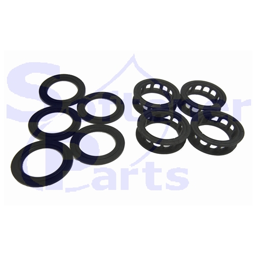

Have a fleck 7000sxt. Started getting less soft water after about 6 years or so. Started by rebuilding the valve with new seals which helped, but then water got hard over time. I replaced the resin with 10%, but still no change. I did the test where I ran the brine draw cycle and tested for salinity at the drain tube and water was not salty and showed 1.0 on refractometer. I think that means my seal is still good. Brine draw and fill both happen correctly. Any reason I'm still not getting soft water?

I've never taken one apart nor worked on one. Your type of bypass is probably OK since it uses a 1/4 turn valve similar to the faucet.
Look at page 14 & page 20 (part 4). Bypass could be going on inside the valve body.
Yup did the seals piston and brine valve about 6 months ago. It has been getting better maybe water heater was built up over time.
