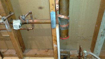

What do i do with the old 3" copper vent that used to vent the hall bath toilet? its still there, see pic. That used to wet vent the vanity and toilet. i assume i can put a transition there and tie the vanity in as discussed above.
i thought it would be an issue if the only vent that ties into the 3" line is a 1.5" sink drain for 2 toilets and 3 sinks (one in master and double vanity in hall bath)?
The 3" copper goes up above ceiling and picks up the other vent line then out the roof. i don't think this smatters as i am not touching anything above the ceiling.
guess i could cut out all that copper and scrap it :)

Terminology wise--dry vent means the vent path to the roof has no section that carries drainage too. One lav in each bathroom is almost always dry vented. Wet vent means the vent path goes through sections that carry drainage to reach a dry vent.
1) If the master is the new bathroom (not the one with the last picture, e.g.) then the lav is dry vented and it wet vents the WC and presumably the shower/tub.
2) The hall bath lav needs a dry vent (because vents are always at the elevation of the trap, and the wet vent from the master bath is under the floor). Then the hall bath lav drain can join the master bath branch drain where ever. The master bath lav can wet vent the hall bath WC, or if the hall bath lav joins upstream of the hall bath WC as previously discussed, sort of both of them are doing it. The hall bath shower/tub is presumably dry vented separately.
3) You need it to dry vent the hall bath lav. And you also need that 3" copper to have a path to drain out if any water ever got in there (i.e. you can't just cap the bottom). So you either need to extend the 3" downward to join the new 3" plastic (it can serve as the lav drain as well, assuming that horizontal copper to the left is the lav trap arm), or you follow it up until it connects to another vent and replace all of that with a smaller size (2" or 1-1/2") so you don't need to deal with bringing another 3" drain into that joist bay.
IPC would allow a single 1.5" vent to vent two bathrooms, but each lav needs a dry vent generally, so really the minimum is two 1.5" vents, at the elevation of the lav flood rims (6" above that they could turn horizontal and combine).
