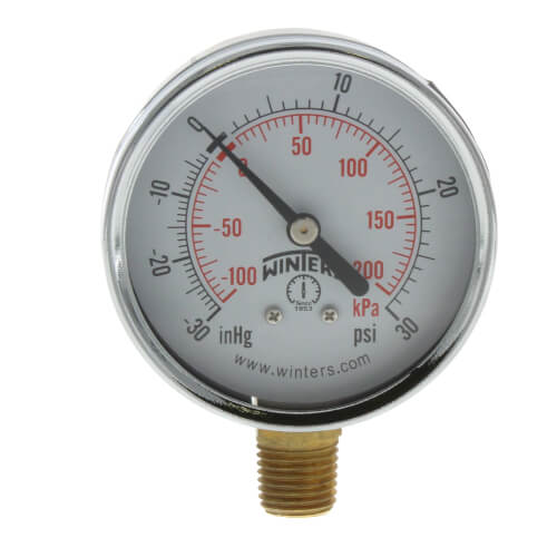

An air leak could do the time thing, I think, but it would also add air to the water.
You could put a vacuum gauge on the well side of the check valve, or maybe a gauge that measures both on the pump side. A 30"Hg-0-60 psi" gauge would probably be the better choice. Of course adding more stuff makes more joints to be careful to not let leak.

That is not what I was saying. I was saying that a gauge on the intake (suction) line could tell you about the vacuum. A strong vacuum would indicate that the problem was that the water could not be readily drawn into the point, but the problem was not a vacuum leak.
When the pump is off, then the pump intake would see pressure, via the pump, from the pressure tank.
Few people have such a gauge.
