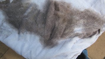

Previous heater had been in place for 19 years without a single noise. Installed A.O. Smith Sig 100 40 gallon. Installed by the book - tank filled and all air expelled before power up. Heats without a sound. Next day when it heats you can hear it 3 rooms away - light whistle, popping etc. Next day drain and pull elements. Elements are heavily coated with brown scale as well as the edge of the element threads in the heater. Replace and fill tank again. Heats silently. By next day the noise starts and gets louder during the day. Next day to satisfy mfg drained again - replaced elements - documented (video) the start up steps. Same results.

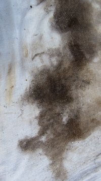

To get a closer look at whats inside I flushed the tank through a cloth. Then filled and cold water flushed it 12 times! The results of whats in tank can be seen on the pics - the darkest the 1st and the lighter the 12th flush. If you rub your finger on it, it feels greasy and stains. This tank will not clean. Our city water has never been a problem and the water entering this tank is clear and all pipes are copper or pex.
As the mfg is dragging feet - any idea what could be in this tank that won't clean.

Is there a water softener? if yes, bypass the softener & repeat. The new anode rod could be reacting? After 19 years on the old unit, there probably wasn't any anode rod left. If you have the muscle, remove the anode rod and cap off with a plug. Give that a try.
I have AO Smith Proline installed last Oct, no issues.
Just may have to call a local plumber. One might have come across this before.

I just installed the same exact WH from Lowes. I can hear it heat if I'm near it but its not very loud FWIW.

if you got it from Lowes, they are sub-standard compaired to the units sold at the supply houses...
I suggest you just claim it is leaking and have it replaced under warranty
if you think something is fishey with the steel in
that water heater,,,,
they wont fight you much over this... just be sure to pour some water down
through the top of the heater before you take it back ...LOL
