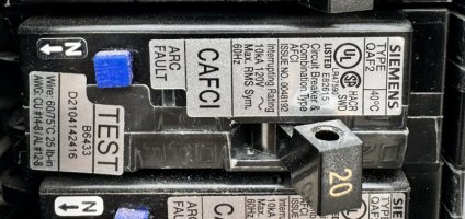

Reviving this old thread as Ive continued to have issues, but my resolution is very weird so maybe someone can offer some insight.
My unit keeps tripping my Siemens 40amp breaker. There are a number of things on the line, but nowhere near 40 Amps. I changed my outlet to a gfci. I changed my 40amp breaker. Ive had the unit serviced, ive done everything. The unit trips when it goes into post purge mode.
I finally connected it to a long extension cord and tried it on a different circuit and no problems. Then I plugged the same cord into the original outlet and Ive had no breaker tripping. Can anyone offer any sort of reasonable explanation as to why when directly plugged in the breaker trips, but when a long extension cord (25') is used it does not? PS I also tried a shorter cord and the breaker tripped again. Im baffled.

Any chance that breaker has AFCI or GFCI?
So you insert a long extension cord into the same outlet, and the breaker does not trip.
Is that a 3-wire extension cord, and the ground pin has not been cut off?

Yes the breaker is afci (I think) and yes you are correct I insert into a long 3 prong cord and it doesn’t trip
