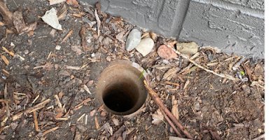

I finally got to this test. The water does drain , it looks like it maintains about 3-4 inches of water at the bottom while the rest flows toward the second pipe. At the base of the second pipe you can just see some tickling water going past, so I think based on my limited knowledge that you’re correct. I also found this pipe beside the front steps in a flower bed, opposite the exterior wall where the mystery pipes are. I tried taping and yelling down them but neither type of sound transmitted, but maybe it’s still apart of the old drainage system? If this is an old drainage system do you think it is safe to cement it closed and put flooring over it? Thanks everyone for the replies!

Its hard to say what it is.. But its easy to guess that the moment you cover it you will need it.
