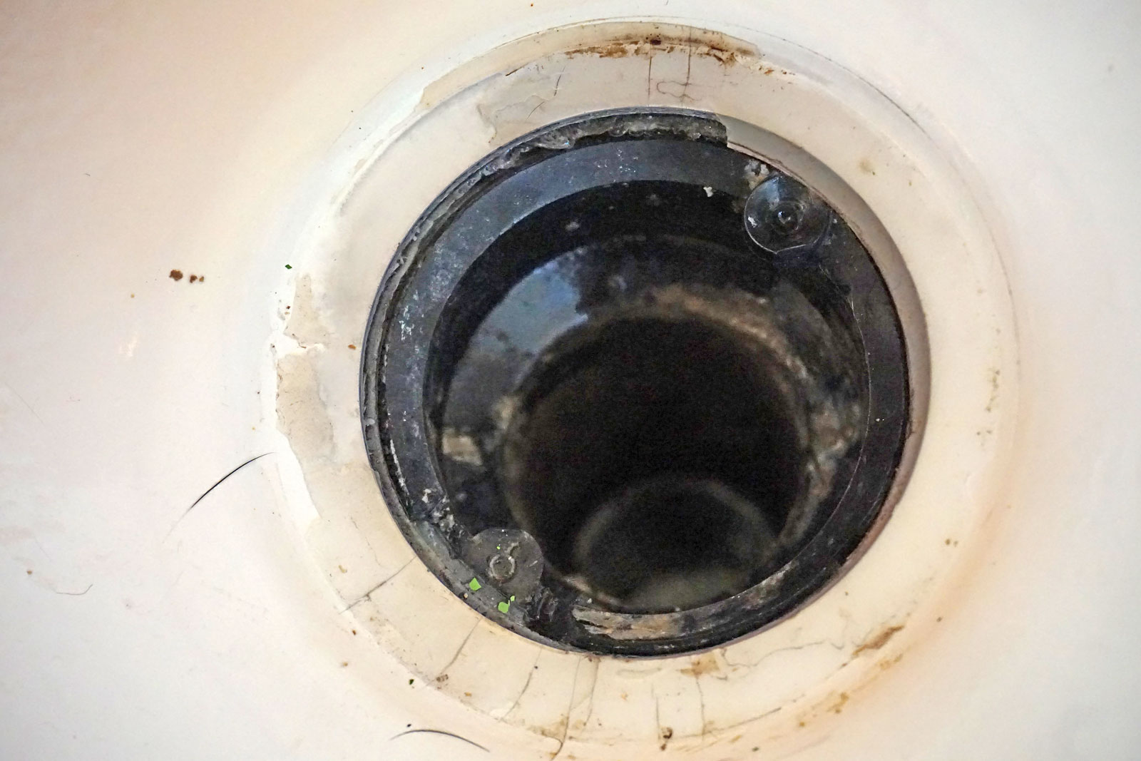

After discovering a nice good wet spot in my ceiling the other night I opened up the ceiling to confirm that my shower was indeed the culprit.
I started by taking the metal drain cover off the shower to discover a small black plastic ring sitting on top of what feels like a silicone putty like substance (1st photo). Below the shower floor is a threaded plastic male piece that threads into the female plastic portion below it making up the drain. The metal cover plate itself is held in place with two screws that thread into the male piece.

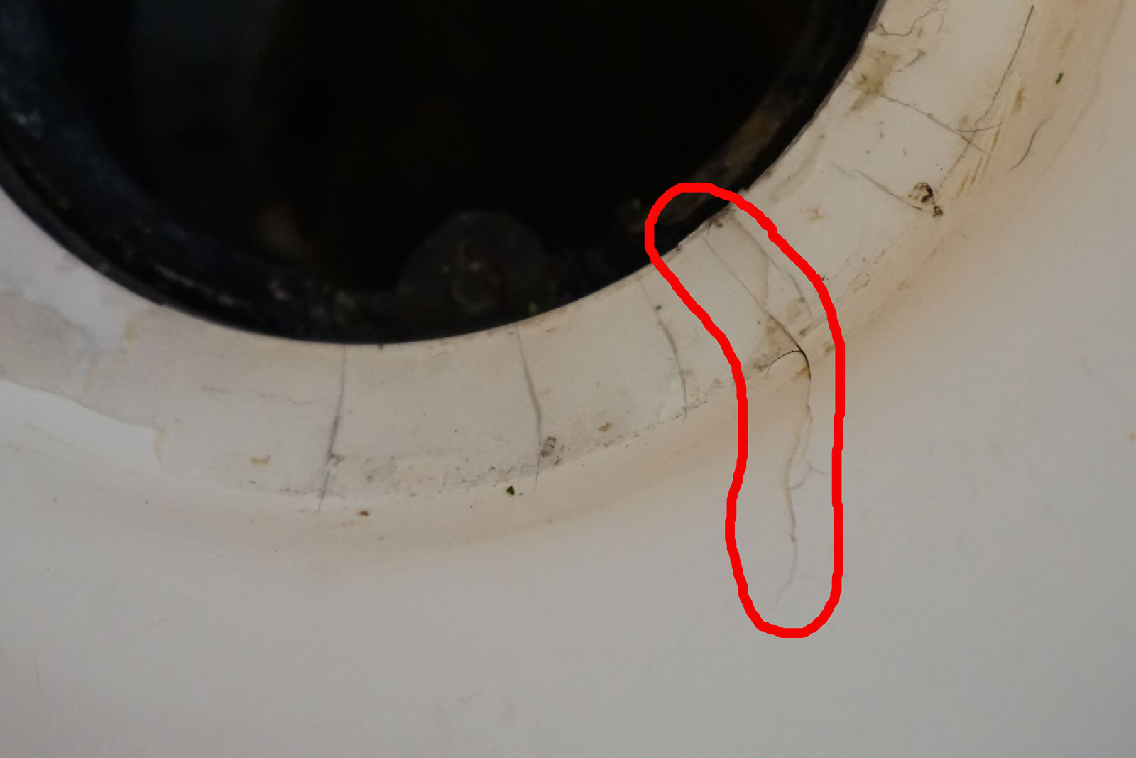

Two things that look like they probably are the cause of the leak are one of tabs that the metal cover plate screws into has broken off (2nd photo, near green dots). The other is a 1" stress crack in the shower floor itself (3rd photo).
Having read through a dozen or more threads on drain leaks on these forums everyone seems have drains that thread together sandwiching the shower floor in between. Mine relies on just the screws in the metal cover plate to hold everything together (compressing a rubber gasket below the shower floor to make the seal).

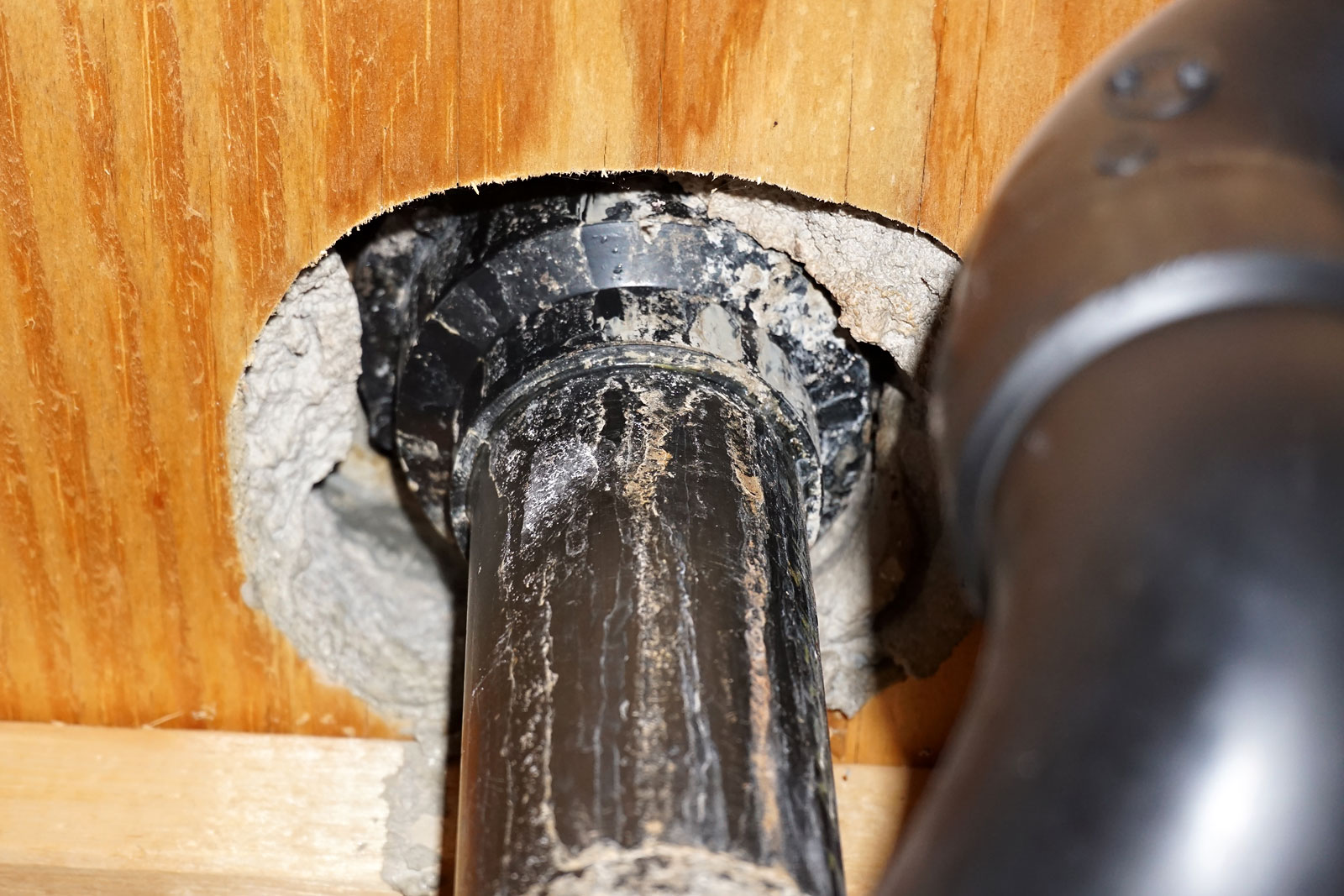

Easy enough to just pull it all out from below right? Not so fast. When they built the house they also added concrete to support the drain area. This concrete actually makes it impossible to pull the drain down from below. If I try and unscrew the drain from above it just pushes up on the shower floor.
I'm eager to try things myself but also know my limitations. Should I be trying to cut the whole darn thing out just above the elbow trap? Get a chisel and pound away on the concrete? Is that 1" crack in the floor (which is basically the entire shower) gonna be a dealer breaker regardless of installing a new drain?
Any advice is welcome!!
