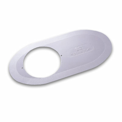

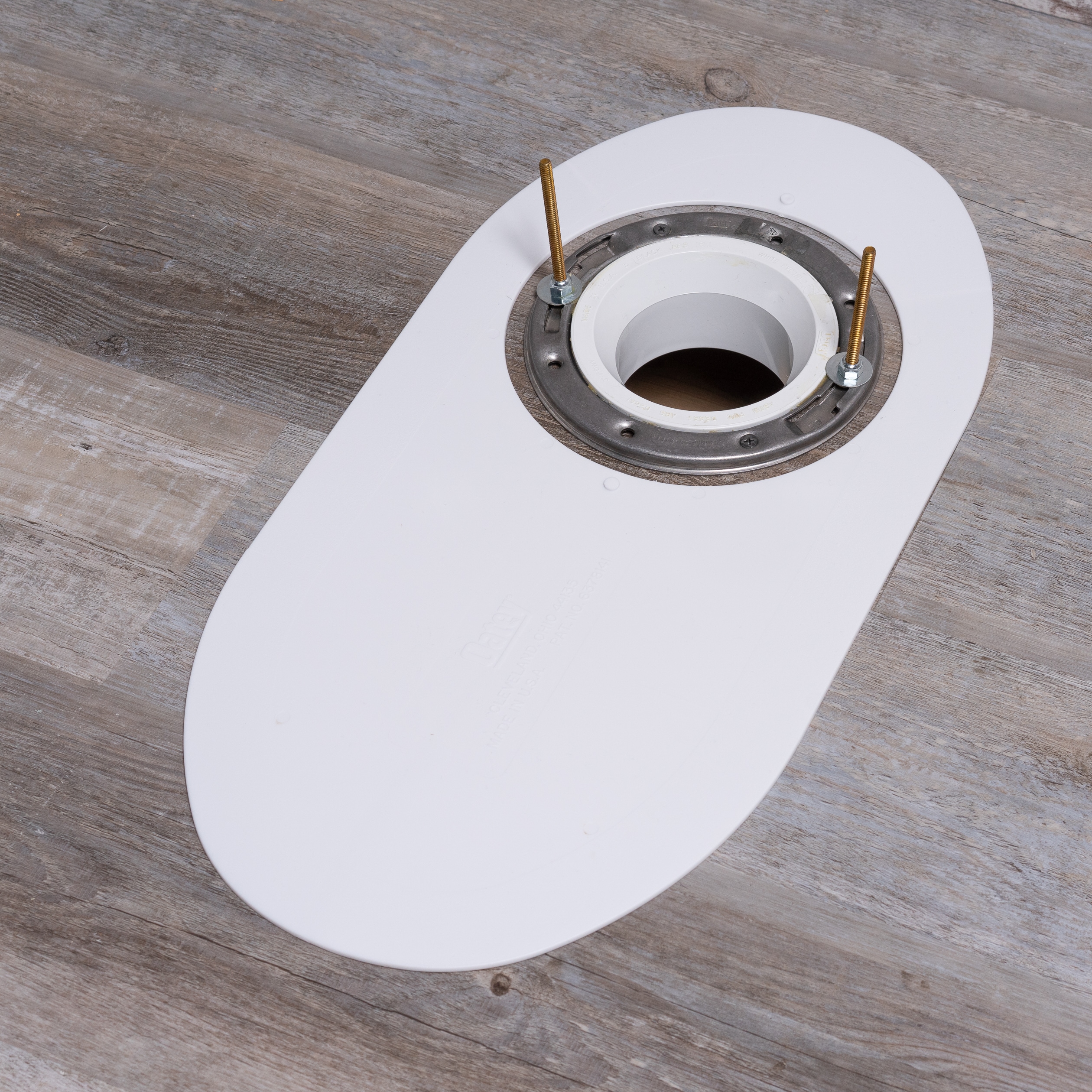

If nobody answers (high probability). You might look for a Toilet Base Plate. That Glacier Bay junk is sub-standard. Also, we NEVER use WC flanges made entirely of plastic and s.s. metal flanges do not have such a high profile.
We use hard translucent plastic wedges, sometimes stacked, then clear silicone to cover the gap (when in a pinch). The wedges can be cut flush to the edge of the porcelain with a chisel and hard hammer blow.

Thanks for the response Breplum...! I saw those plastic spacers but not ready to go down that path just yet. I replaced the ABS flange on the first floor half-bath toilet with the same kind in your picture, which worked fine with the Glacier Bay toilet, along with a section of rotten sub-floor from a leaking wax seal. That project was much easier because of the crawlspace access underneath but the other two bathrooms are on the second floor.
