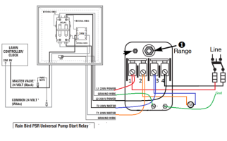

Looking at https://www.rainbird.com/products/psr-universal-pump-start-relay (there are others)
They show two model numbers. I kinda think the same diagram applies to both, but I could be mistaken.
Actual wire colors don't matter much, except ground should be bare, or green, or special yellow+green. The wires shown in orange, red. blue. and black could all be black, or all red, or all blue.
Thing on the left is a Rain Bird universal pump start relay. Thing on the right is a common pressure switch. If this mostly makes sense to you, ask specific questions. If you are lost, confer with a friend who has some electrical knowledge.
This is exactly what I've been looking for on-line and couldn't find. My only concern would be supplying the pump with 2 sources of power at the same time. I would think that the pressure switch contacts would not close since the pump is running and producing psi.

Note that the pressure gauge, the pressure switch, and the input to the pressure tank should be very close to each other. Pressure drops in pipes that are carrying water. A nipple, even a long one, will not have pressure drop due to flow, because there is no significant water flow to the pressure gauge or pressure switch.
You understand that having the contacts in parallel does not change the source of the pump power. Controller power does not go to the pump. Controller power does go to the input of the relay, which powers an electromagnet. The electromagnet just moves the switch without providing electrical power to the relay contacts.

It is a common failure mode of a pump start relay. In some areas it is more common than others as it has to do with varmints and electrical damage to the wires that go to the sprinklers. Wires to the sprinklers or zone valves get damaged and the pump start relay doesn't know the sprinklers didn't come up. Adding a pressure relief at like 75 PSI is the normal way to protest from melting the pump down when this happens. But with a pump that only builds 56 PSI that won't work.
But pump start relays are used all the time. Just wire as instructed above. Probably less expensive to replace the pump if something happens than to try to protect it from problems. If the amps drop noticeably when the pump is deadheaded, a Cycle Sensor would sense that and shut the pump down.
