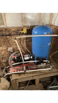

Hi everyone.
So I am running a jet pump and it keeps losing prime or pressure.
I live on the side of a lake and run our line straight into it. Our pump seems to run perfectly except it loses prime every couple weeks.
This happens during the middle of the night and leaves the pump running all night with no water until I wake up and re-prime it. I’m worried this will blow the pump.
It seems to have no leaks in the lines and I do believe the foot value is good as I was out at the end of the line a few months ago.
Could this be a pressure tank issue and how would I check if it is???

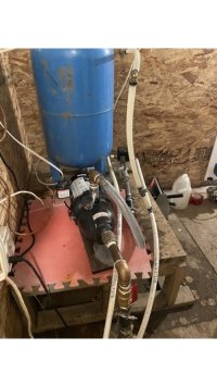

No other check values.
And there is a forked pipe at the top of the pump you open to prime. You can it in the photo. It’s the silver one
How did you come to that conclusion? A suction leak is invisible to the naked eye. A small suction leak could accumulate air at the top of the diaphragm that could survive many cycles until it grew large enough. Combined with a leaky footvalve, that accumulated air once large enough could displace the prime.

Another thing to consider is the pressure your pump is able to build and the pressure settings on your switch.
If the pump can only build a maximum of 58psi and your switch is set to 40/60, the pump may never turn off.
I'm not saying that this would cause you loss of prime. But that, in addition to other issues, means that you could be chasing your tail when trying to resolve the issues.
1. check your pump specs to make sure the max psi it can build is higher than your pressure switch cutoff.
2. Make sure the only check valve is the foot valve.
3. Tighten every hose clamp on the suction line
I have a tee and a valve on the discharge port of my pump. The valve allows me to easily purge any air that may accumulate.

I didn't see your pictures before. In the intake pipe, you have a ball valve. What's about 6" below that? Looks like brass.
Bannerman
5,364
1,008
Ontario, Canada
Appears that it may be a check valve.
With so many connections in the suction line, there is too many opportunities for air to enter.
A top mounted check valve as suspected, may be preventing the foot valve from reliably closing fully. Any leakage through the foot valve, will cause the suction line to remain under negative pressure while the pump is not operating, which will pull in air through any leakage point.
Recommend removing the top check valve and ball valve from the suction line, to minimize the number of connections. Without the top check valve, whenever the pump is not running, the suction line will be subjected to positive pressure from the pressure tank. The positive pressure will assist the foot valve to fully close, and there will be less potential for air leakage while the pump is not running.

And yes chucky you are correct I only have the foot valve and no other check valves. The other brass fitting is a second ball valve for no apparent reason. ( my uncle added it ) I know I need to get rid of this and minimize connections I was just hoping to get to summer first…
