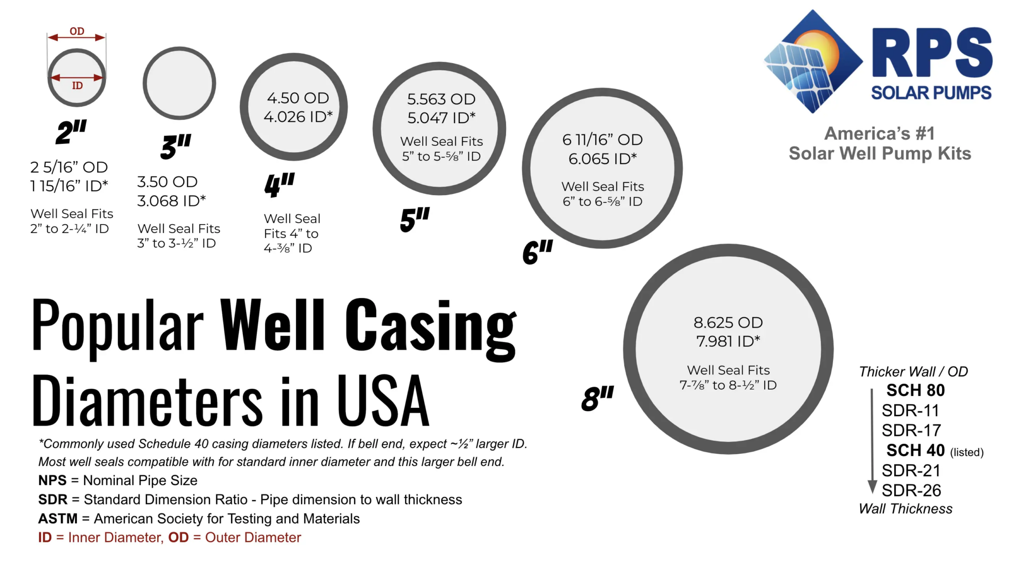

To measure the ID, you may be able to measure the circumference, and divide by pi to get the OD. Then subtract 1/2 inch to get close to the ID. https://www.rpssolarpumps.com/learn...re-a-well-casing-and-well-seals-vs-well-caps/ looks like a very useful page, that includes this picture:
