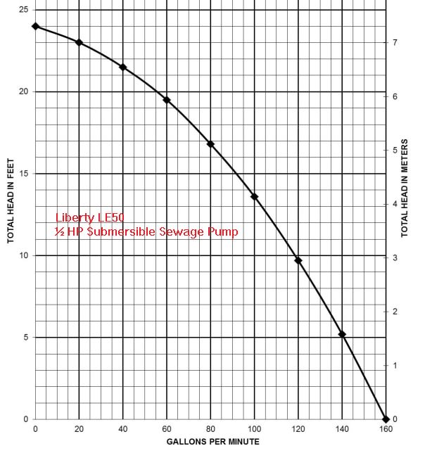

How do I know if a pump is stronger if I know the current discharge rate is not sufficient, for example, this 1/2 hp liberty pump has rate of 8400 GPH at 5ft, but the 1hp pump I got only has 7250 gph at 4ft. (curves from manufacturers attached), but requires much higher current/power than the 1/2 hp pump. The 1hp pump seems to have higher head according to the curves though. How do I compare this two pumps, if the max rate (speed at 0ft)matters, does it mean that my 1hp pump is not as strong as 1/2 pump i have right now (different brands)? I ask this because it looks like the failure prone portion of most pumps are the float switch, I was planning to use a Hydrocheck H6000 high-lo electric switch with the pump until I noticed that the switch is rated at 13.8A while this 1hp pump is 14.2A rated (3/4 hp ones would draw less than 12A which can be used with this switch). I attached the current Liberty pump 's curve and the new pump I just got (circled out the 1hp and 3/4 hp ones). If 3/4hp is what I need, then I would couple it with the electric switch no problem.

How high are you pumping? How far are you pumping? What are you pumping into?
I suspect the 1/2 is plenty, but that depends on what you are doing.
