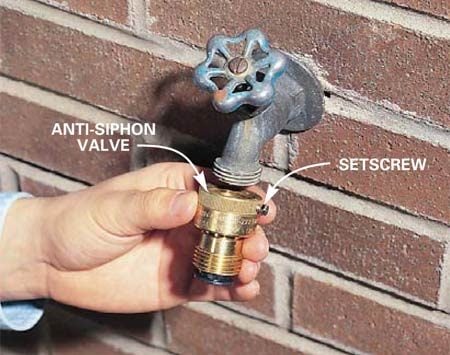

Here is an example of a built in backflow preventer

This is just my opinion but I have had those screw-on anti-siphon adapters corrode and go bad and need replacement, so I remove the set screw now when I put them on. Otherwise it's a real pain in the neck to get them back off again and replace them.

The set screw is designed to snap off for a couple reasons. If its your personal hose bib I suggest removing the set screw also.

If you have where the snap off screw is broken, I find a good size set of channel locks works the best. Vice grips will distort the brass vacuum breaker making it harder to unthread it. One time the vacuum breaker was frozen onto the spigot. Must have been some kind of electrolysis going on because the hose connector was some kind of pot metal, not brass. I had to use a dremel tool to split the vacuum breaker down its side.
