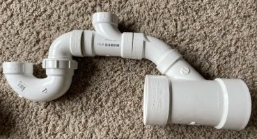

I have a similar situation with a softener drain p-trap that is currently installed with a clamp on "Tee" fitting. I am replacing my entire main horizontal drain (no slope across 60') and will be replacing this fitting with a "Wye" fitting. Here are my questions:
1. Should it be rolled up or is it acceptable to just have a 1/4" slope?
2. Should this drain p-trap have a vent installed?
1 no need to roll up
2 Looking at the picture I assume the santee is for a vent, yes its needed to be vented and your code allows a santee on its back to be used venting
