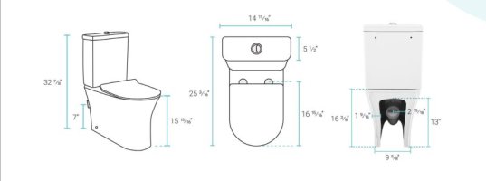

Hi everyone, I hope all is well! I was hoping to have your guidance on a plumbing related question.
It's regarding a floor mounted rear outlet toilet and shifting the rough-in height. I currently have a Briggs 7340 installed (rough-in height of 4 1/4 inches above the floor/slab). The toilet I would like to install is a Swiss Madison Calice - SM-2T120 (rough-in height of 7 inches from the floor/slab). I was wondering if you could please provide any insight on how to install this new toilet in code-compliant way. I've heard of using a pan connector, but I can't find any in the US and am concerned about how it would work with the toilet's flange bolts/ toilet bowl gasket. I'm also attaching a drop box link to a folder showing pictures. The first link is of photos I found online and shows the Briggs toilet removed plus the drywall. The second is a picture I took showing the back side of the rear outlet drain.

Hi Jeff, I initially thought it would be easier to view photos by attaching links, but I will also upload them here if it makes it easier. Sorry for the inconvenience. The reason why I asked if I can install a Swiss Madison Calice - SM-2T120 (rough-in height of 7 inches from the floor/slab), when my current rough in height is 4 1/4 inches is because my neighbor has this toilet (The Swiss Madison Calice - SM-2T120) installed on the same floor mount rear outlet/discharge toilet as I have. Knowing that, I did some research but reached a point that confuses me. I've heard of people using a wc flexi pan connector (picture attached) in this situation, but I can't find any in the US or any from a reputable plumbing supply here in the US and another fact I'm concerned about is how it would work with the rear outlet's flange bolts/ toilet bowl gasket. This leads me to believe that wc flexi pan connectors are not code-compliant in the US, but I could be wrong and wanted to clarify if there is there a code compliant way of connecting this toilet to my rear outlet system?

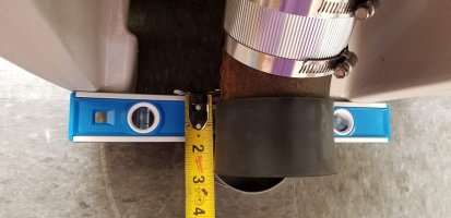

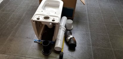

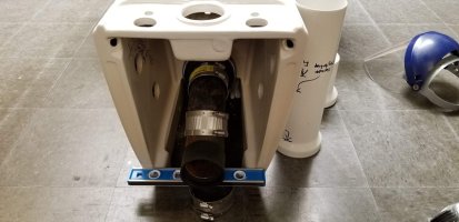

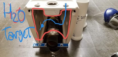

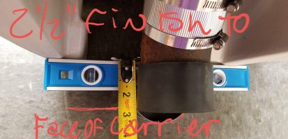

OK.. I've actually done what you're attempting to do and its really difficult unless you can bend cast iron.
I adapted a 4 bolt closet carrier to accept a european style floor mount rear discharge like you've shown. Those toilets require a unifit style adapter to be offset to the wall carrier. I accomplished this by knowing the exact heights I had to work with and the depth available. I cut down Two 45° cast iron no hub elbows to shorten their height and length. I connected that contraption to the wall carrier with a duravit toilet connector and the toilets slid right into place.
Tuttles Revenge
4,459
1,575
Here are the photos of some of the work I put into making a European style floor mount rear discharge toilet fit to a 4 bolt wall carrier.

Yeah, they turned out really nice. We installed shut off valves under the sink with a long "supply tube" that entered behind the toilet up to the tank. My original design was to have a shutoff in a recessed box next to the toilet like an ice maker box. But because the wall was a fire wall it became problematic. Of course I can't find any photos of the finished product.

To my understanding the Swiss Madison toilet trap size has a 3 inch diameter so I am thinking the following build might work:

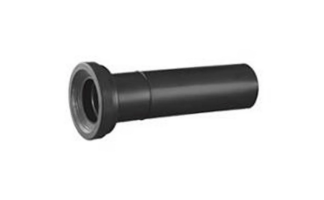

When we did ours, we used the NoHub coupling to connect the 45° offsets with the connector directly to the carrier barrel. With those fairly solidly in place the toilet simply slid into place. The reason we used the cast iron fittings is because they are "Street" fittings on both ends.. meaning we could connect the adapters at each end of the fittings which you can't do with plastic DWV fittings. The space behind the toilet didn't have any room to spare in our scenario.. yours may allow for that additional 2 inches of space.
The adapter shown on the back of the toilet picture looks interesting. You would need a clamping closet flange to attach to the barrel to adapt that.

Hi, Thanks for the reply and the explanation. I was just wondering if you had link or a picture of this clamping closet flange. I am aware of regular closet flanges, just not the clamping ones. Additionally, if I go the cast iron route, which tool(s) did you use to shorten the 45° offsets?
Tuttles Revenge
4,459
1,575
This is 1 example of a cast iron clamping closet flange that would go on the outside of your drain barrel
I cut the cast iron 45's with an angle grinder using a diamond blade. I unfortunately don't have pictures of that process. But it essentially emulates what that fitting in the back of the toilet photo is doing.
