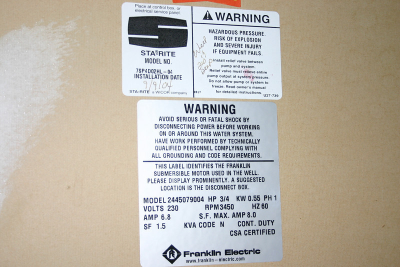

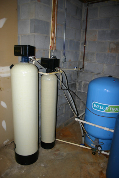

    Don't know much about wells in general, ex-city water person here.
    I'll let the pics explain what I have and ask quesions below.

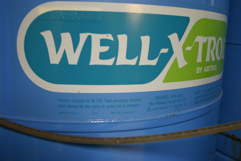

    model wx-302 charged to 38psi

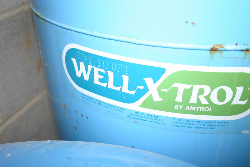

    model wx-252 charged to 30 psi

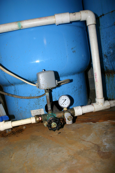

    normally gauge reads ~40 psi
    [​IMG]

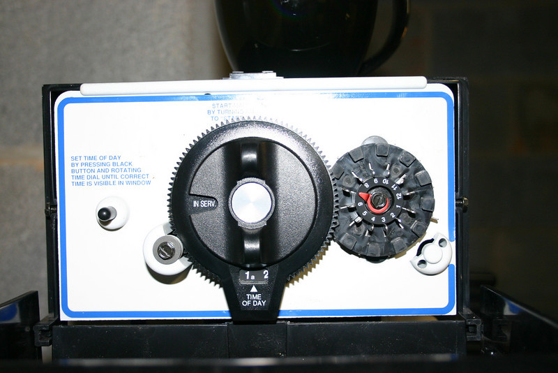

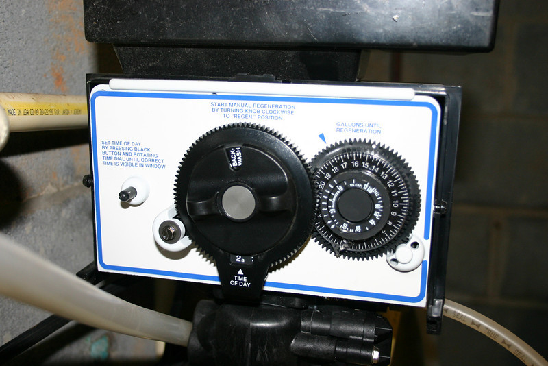

    Don't really know what these guys do, other than it has something to do with regeneration. Last time the well guy was in, he dumped a bucket of softner(?) into a larger tank and adjusted the dial as I told him we were going through a lot of salt. Now I dump a bag about every 2 weeks.

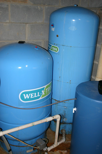

    Larger tank
    [​IMG]
    Smaller tank
    [​IMG]
    Now, questions
    1. Why do we have two tanks?
    2. Why are two tanks charged to different pressure (or rather labeled as such) and what does it mean for overall pressure and switch?
    3. Can the pressure be increased and if so, how?
    4. What is the GPM rate of my pump? Is there a way to tell from the specs of pump/well?
    5. Is there a good read on overall well operation?

    I think you want to know why two blue tanks not two tan tanks. I would imagine either one went bad and someone didn't want to drag it out full of water or they thought you needed more drawdown to protect the pump. Are either of these two tanks extremely heavy?
    The label on the tank tells all about the Franklin motor but nothing about the pump.
    bob...

    I did mean the two blue tanks. I have not tried to move them.
    The tan ones are (I think) neutralizer and softner.
    What's the Sta-Rite? Is that the pump? I can't find a manual for that model number. And what's the motor then?

    Why do you have two WellXTrol pressure tanks? Because some guys like to 'store' more water if the well is allow producing well or to prevent the well pump from starting frequently.
    Both of them should have the same air pressure precharge, which should be 1-2 psi less than the turn the pump on switch setting; I.E. 30on/50off gets 29-28 psi air pressure with no water in the tanks.
    There is a Sticky post at the top of this forum and IIRC tells you hpw to change the pressure switch settings but see below.
    If you mean the other two tanks, you have a filter, probably an acid neutralizing filter for low pH acidic water and a softener because of hard water, iron, manganese and the hardness the AN filter adds as it buffers the acidity. You have Fleck 5600 control valves; softener is metered and the filter is a time clock model. Which one of those does the water line from the pressure tanks go to first? It should be the AN filter; that has the plug hole in the curved part of the top of the tank.
    Unless you took those pictures at 1 AM and then 2 AM, the time of day is wrong on the control valves and, the softener was in a regeneration. That incorrect time will allow backwashing and regeneration at other times than 1 and 2 AM when they should do it. That will cause low flow while they are using water and the water quality will be reduced because you'll get raw water then until they are done. The filter you lie to and set it one hour ahead so the correct time of day on the softener, so it is done backwashing before the softener want to use water at 2 AM.
    To find the gpm of the pump you need to look up the model number on the manufacturer's web site or the pump's manual. Or someone here that can read the gpm in the model number can tell you.

    Sorry I missed the sticker above the Franklin sticker. The pump is a 7 gallon per minute pump.

    Thanks for the replies. How can I tell what switch do I have now?

    Even using a magnifier I can't see what it says on top of the switch. It is either a Square D or a knockoff of one.

    I think you mean the settings of the switch rather than the name of the manufacturer.... I think the name should be inside the cover or on the outside top of the cover but they all work the same.
    Run water while watching the gauge, when the switch clicks, note the gauge reading, that is the cut in setting. Shut the water off and watch the gauge, when the switch clicks, the gauge tells you the cut out setting.

    Sorry, I meant 30/50, 40/60 etc? It is a Square D
    Gary, just saw your reply, thanks, I'll check tonight
