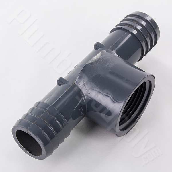

Do those gray fittings have mold marks? I would not use those, if so.
41,408
4,996
First, I would use brass.
By mold marks, I mean like the horizontal line you can see on this picture:
I understand that is not the fitting you are using, but it is a barbed fitting with the kind of mark I wanted to illustrate.

Actually yes they do, I hadn't noticed that, it is not very pronounced.
