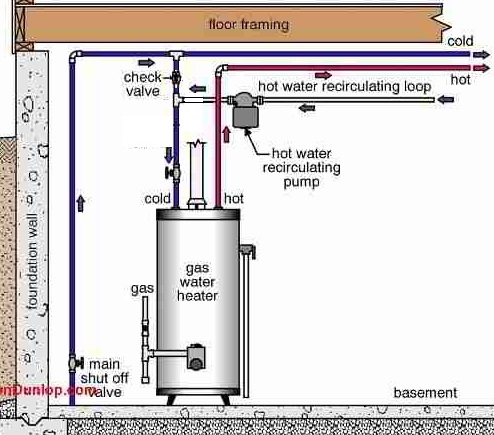

1. jadnashua had mentioned that by the looks of it, we may have a hot water recirculation line, but just like the trick of turning on the hot water and feeling the pipes to determine which is the hot water pipes, (as mentioned to me by bob_cville), is there a way to determine if we have a hot water recirculation line?

With recirculation systems the IRC code requires that both the supply and return get insulated. See section R405.5.3, item #7. (You would usually know if it's a "demand" type system, which requires you to activate a switch to call hot water, or there would be a flow activated control somewhere under a sink, usually at the far end of the house from the water heater.)
All recirculation systems have a pump, usually located at the water heater end injecting the return water into the cold-feed side of the water heater. It can be mounted high or low, but usually close to the heater:
But sometimes they' sneak it under a sink cabinet or elsewhere.
