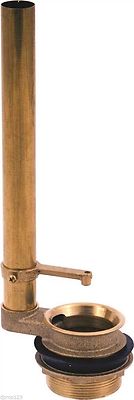

An old, but working, toilet is leaking on the underside of the tank at the flush valve outlet.
See pics. part of leaking area circled in yellow.
I can't tell if the seal/gasket is age hardened rubber or metal.
Anyone know where to get a replacement seal?
Replacement looks like:
Remove tank to bowl pipe via remove 2 nuts
Remove lock ring
Remove nut on bottom of tank
Replace seal and reverse.
The nut on the bottom of the tank could be a problem to loosen if it is frozen.
Would there be another nut on the inside of the tank that needs to be held so it doesn't spin?
Toilet always flushes and never clogs. Would like to see it get to 100 years old : )
Thanks

Beautiful toilet! You need to have a professional plumber tackle this, especially with installing the shut off lines, etc.
Taking the tank off the wall is going to be a challenge, and you will have to install new hanger bolts into the wall when you put it back.
It appears from what you described that the flush valve seal must be leaking. I would replace the entire flush valve with a new brass douglas flush valve and tank ball. That will eliminate any future problems you could have with the existing brass curtain flush valve (which I believe they don't make parts for anymore). I would also put a Korky Quietfill or FluidMaster fill valve in as well.
OR - if this is a very small, occasional drip, you could leave it alone and seal it with a little silicone caulk.

It appears there is a leak between the flush valve and the tank. The seal will have to be replaced. Those old 1920s toilets in my opinion are better than anything they make today. I would replace the flush valve and flush valve seal.

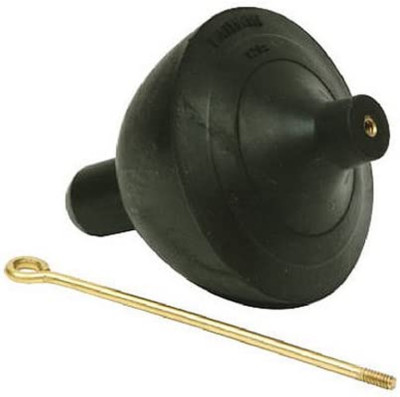

I looked at that Douglas valve.
It looks like something is missing; the part that starts and stops the water flow?
Thanks

Here is a link to a flapper that should work with the flush valve. This is the part you need
