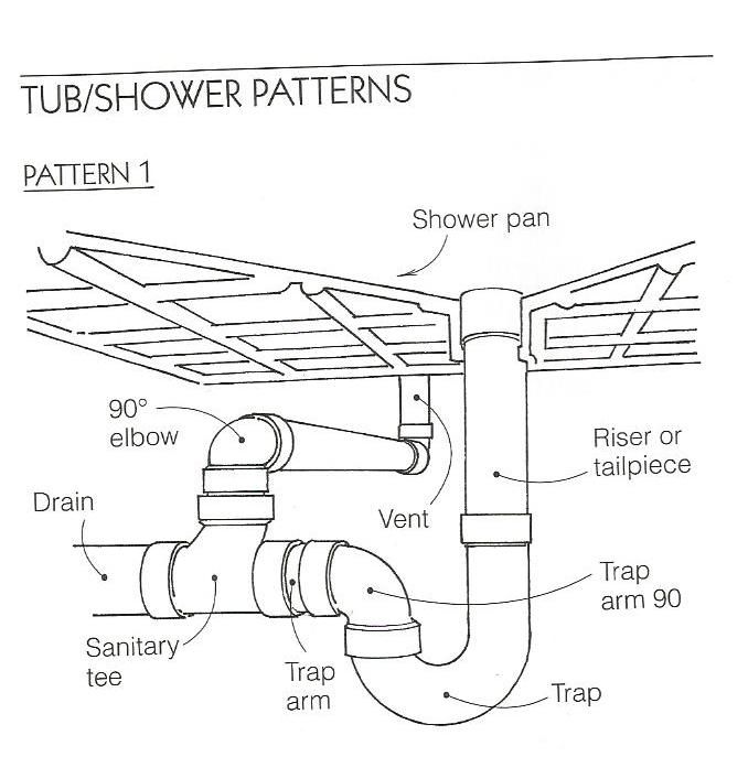

Interesting about the shower dry-vent. Could I use a "Sanitary Tee with Side Outlet"?
How long can the horizontal portion of the shower branch be after the trap to the stack (I would be 6')?

yes but does that stack take drainage from above on another floor? I never used the side outle tsantee but have stacked a 3x3x2 santee on top of the 3 inch san tee . again clearly the vent cant be used for drainage from another floor.
Yes, it does take drainage from above. Ok, scratch that idea.
Back around to my Challenge here. I would have difficulty adding a 'dry vent' to the tub, because of the layout of the room. There is no way for me to go vertical until very far from the tub...
Do we think that MA does not allow for wet vents? (Such as in terry's photo?)

there is a wall of some sort 2 inches away from the tub drain ? perfect for a vent plus there is a side wall i presume

Appreciate your patients with me, but I didnt think that I could go horizontal with my dry vent. Would the image below for a dry vent on a tub be kosher?
No, a dry vent can't be horizontal until it is at least 6" above the fixture flood rim. That image is obsolete.
I could make a suggestion on DWV layout for the bathroom, but I need a bit more information than is in the diagram in the OP. Which way do the floor joists run, and if left to right, will the closet flange for the WC lie over the same joist bay as contains the stack? If not, how deep are the floor joists, and will you be able to make 3-5/8" (minimum) diameter hole(s) in them for the 3" WC drain? As the stack receives drainage from above, where can your dry vent extend through the ceiling to ultimately connect to a roof terminal?

nope didnt suggest that..... run a 2 inch line ove to the tub wall arund a ft deep then 90 up with long sweep on top of 90 place a 2 x1 1/2x1 1/2 san tee with ptrap below floor vent rises up through the floor and then take it wherever you need.
floor joists? I thought this was on concrete ?
