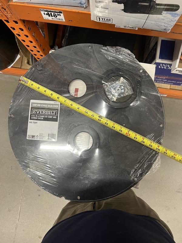

The diameter of the lid is 20.75" and the inner diameter of the tank is 17.75". There are 4 bolt holes but there are no threads. Maybe this lid?
So the pump works and the float works now but easy enough to replace since maybe its worn. Not sure of the pump age either. Clearly need a new lid.

looks good . meaasurement on cover sounds sounds close enough . just gotta figure out how you want to bolt it down.

The old lid was held down by gravity -- no screws? If gravity before, then I expect gravity again.
If doing that with that Everbuilt basin cover you will have a 1/8 inch gap around. I am thinking that you would use putty, and the putty would expand into the gap after you step on the cover for a bit. The putty, formed into a rope by you, would also expand into the screw holes also I think. I am not a pro.

The 4 existing holes on the tank have no threads. When the old lid came off the bolts were rusted and whatever type of threaded female adapter came out with the lid. Its just literally a hole and there is no concrete under the lip. Its just dirt. Im thinking maybe self taping screws through a new lid right through the lip with new holes.
b8a3630e-aadb-556b-b3b1-e383705546f6
I bought this exact lid last night and it doesnt fit. The lip on the bottom of this cover has 18" diameter and the inside tank diameter is 17.75". It wont sit flush. I found a few Jackel lids that measure 17.75" so Im going to try that.

If you leave the pump cord much longer, it may hang up on the side of the basin.
Maybe you can tap the existing tank holes and then use stainless steel bolts with washers, seal it with silicone caulk for odor.
