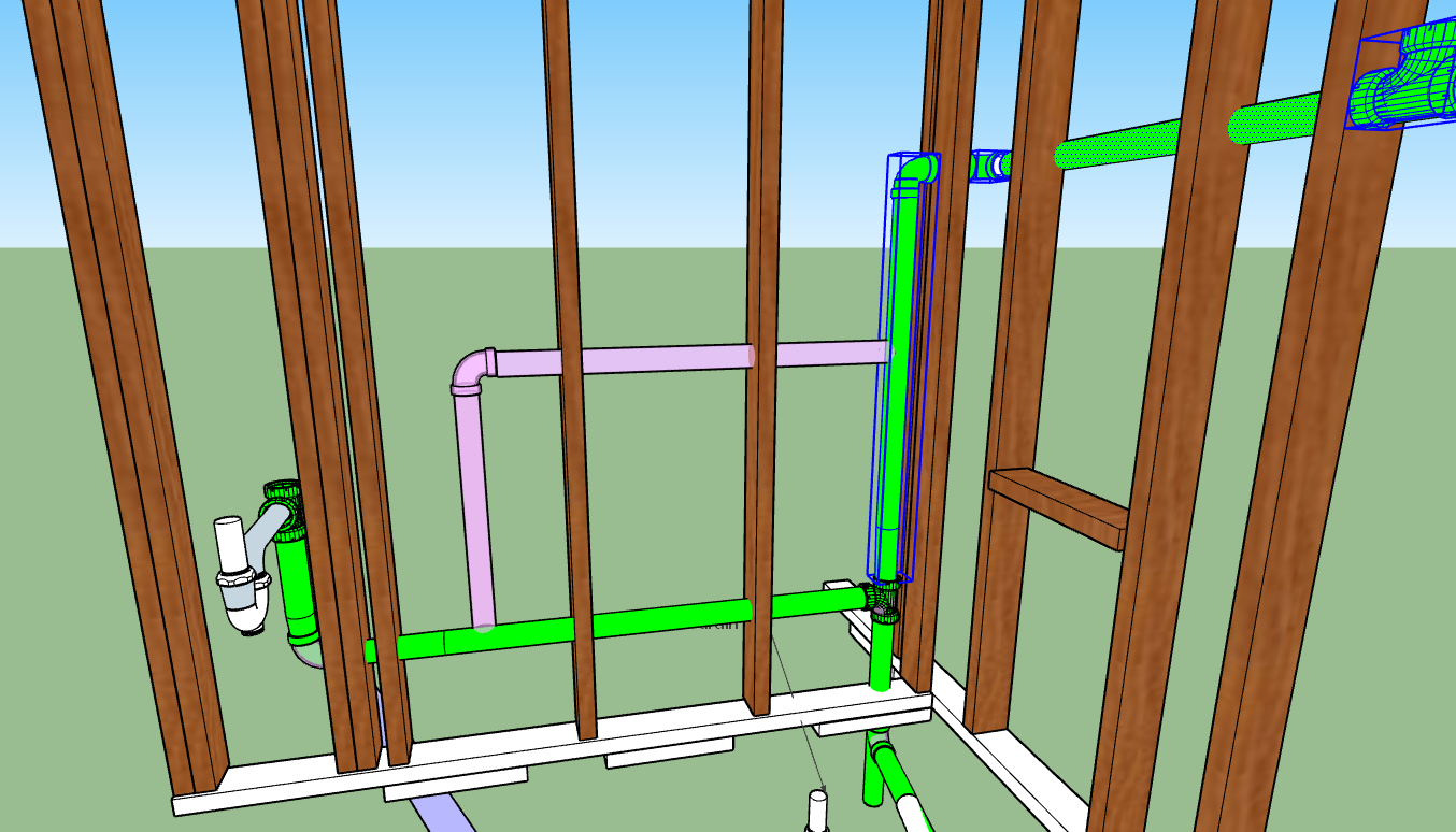

Here is the layout and I am questioning the need to have the purple segment
the green blue selected segment is already in place, the green segment between the shower vent and the sink is what I am building (still dry fitting the pieces but I did not drill the holes for the studs to the left of the vertical green segment
As mentioned the distance between the two green verticals is 4'
this is all 1.5" ABS pipe

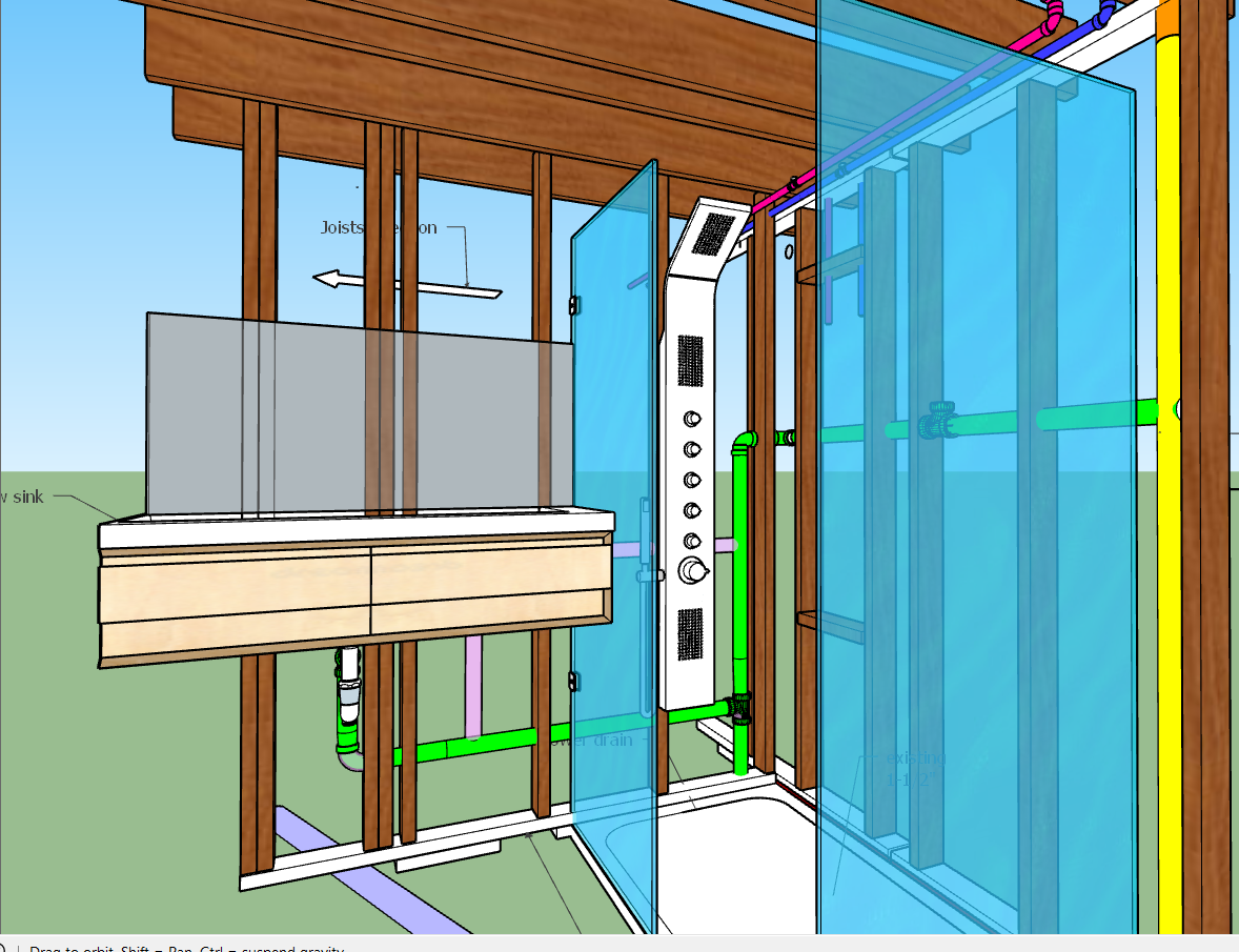

As you can see in this picture the studs that are in the middle of the hrizontal purple segment are going to support a glass panel for the shower
I would like to have those studs as solid as possible so if I could I would avoid that pink vent segment

That TEE in the upper horizontal section implies it is a drain line, in which case you DO need the purple section, BUT, you CANNOT connect it back to that vertical pipe.

that T that is behind the glass panel in the last picture is there to connect a drain for a furnace condense pump which is pumping very little like 5ml once in a while (small house) so it is practically more like a dry vent and that end of that green pipe that is behind the glass pannel (right side) goes up to a vertical dry vent

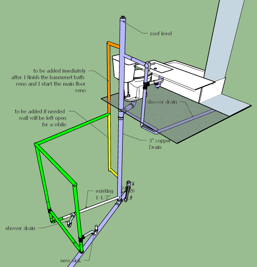

full picture of the project posted a while ago in my previous threads
