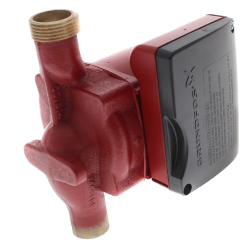

I've decided to definitely install a hot water recirculation system for the full bath. I may add the half into the loop, but I fear that there might not be a real advantage in doing so. I'm mainly curious about the pump I'm considering.
The supply and return line (green in the photo) will be 3/4" with a manifold in the plumbing wall. I want to use a switch operated pump instead of a timer or sensor-controlled one. I found this Grundfos model UP15-10BUC7 that I believe will work well. Here are the specs:
Max Pressure (PSI): 145
Temperature Range (F): 36°F - 230°F
Connection Size: 3/4"
Connection Type: Union
Max Flow (GPM): 6.6
Flow Range (GPM): 0-6.6
Head Range (ft.): 0-6.6
Max Head (Ft): 6.6
I'm planning on having the return line (green line in drawing below) enter the water heater at the bottom using a tee fitting on the drain bib. I believe this pump has a bleeder screw to allow one to purge the air from the system. I was planning on mounting it vertically in the pipe that goes down to the drain bib or if that's not a good idea then somewhere near the water heater.
Does anyone see any problems with this pump or layout?
EDIT: From doing a little research, it seems that having the return loop enter at the drain bib might not be a good idea and that the return loop should enter the water heater on the cold inlet side with a backflow preventer valve in place to keep it from entering the cold supply. Which is correct?

You want the return line to enter the bottom of the water heater. Not the cold inlet.

About 50 feet if I only include the full bath, and about 75 if I include the half bath.
You need to look at the pump curve. You have 4.5 ft. of head. What gpm does that pump at with 4.5 ft head?
Question: how did you come up with 4.5 ft of head? If just pumping around a loop, of a given (equivalent) length and fixed inner diameter, I would think the head the pump sees is just the frictional losses in the pipe. Which depends on the flow rate, so you'd need to take the two curves and find their intersection. But I've never actually had to select/check a pump before.
Second question: when pumping through a big water heater tank, does that add any head? Or is it negligible and you can just look at the piping length?

Right. 75 ft. of pipe creates 4.5 ft of head. 75×0.06=4.5
That it's just a general multiplier used to approximate head. There is a much much more complicated way to do it that will get a more precise number. But the difference is negligible enough the industry (hyronics) uses 0.06. That figures in elbows and other restrictive devices such as a water heater or boiler.
For a run of pex with no fittings one could use 0.03. But remotely sizing a pump I use the better safe than sorry 0.06.
A pump curve should have the gpm along one axis and the head along another axis. If given a head OR gpm AND a pump you can easily find the third variable which is provided by the pump manufacturer.
