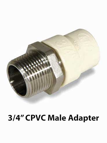

So this 3/4" CPVC fitting was threaded into a Cu fitting in my attic, in the solar hot water loop. It let go with a bang on a nice sunny day with the circulator running and fortuately I was home to turn off the water. The actual domestic hot water is circulated throught the solar panels, it's not a separate loop. As it was there was a lot of water that came out, maybe 20-40 gallons, and fortunately mostly ran out (through light fixtures, bubbled paint, ... Had to replace wet insulation and replaced the fitting with a SharkBite. Question is, how did this occur? Pressure in well pump tank is 45 psi max.

A solar panel can make water/ steam over 300 degrees. There should be a way for your system to relieve pressure and or drain itself. CPVC isn't what I'd call a good material for a system capable of so much heat.

I'm not sure off hand proper use of a plain male adapter on CPVC generally the ones with metal threads are used I suppose non pressure applications or cold only but I've never used one of those its been a long time since I used CPVC but I would either get rid of those adapters or check the spec I'm almost positive they are no good for hot

180 degrees max temp , whatever it takes to stay below that temp. or repipe it with rated pipe use CPVC to brass transition fittings on hot water I'd replace all standard male adapters on the hot with those transition adapters

100% agree with John. Replace it with machined fitting with metallic threads. Read your glue bottle. Give your joint plenty of time to cure. And honestly, if that water/steam is getting 300-degrees, I would replace that shit with type-L copper.
