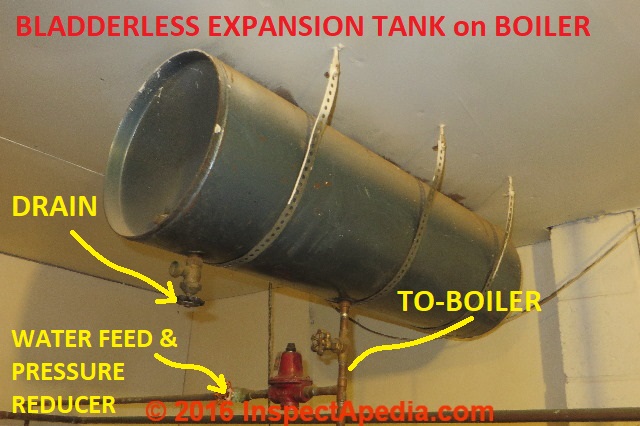

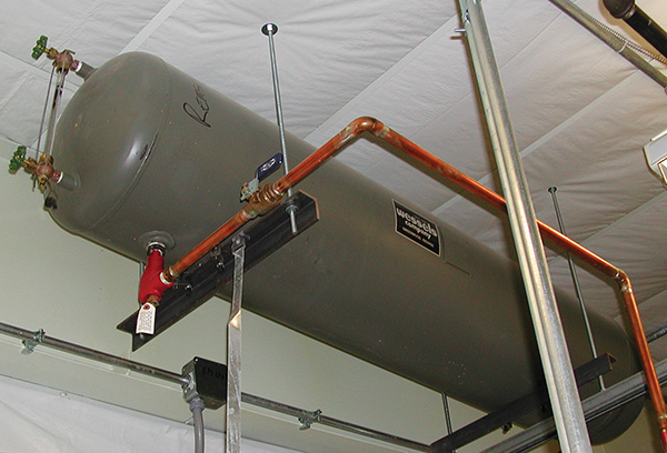

EVEN this picture proves your right as TWO isolation valves are not to right and one should be removed huh?

Here is an another "failure" according to you
