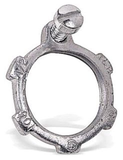

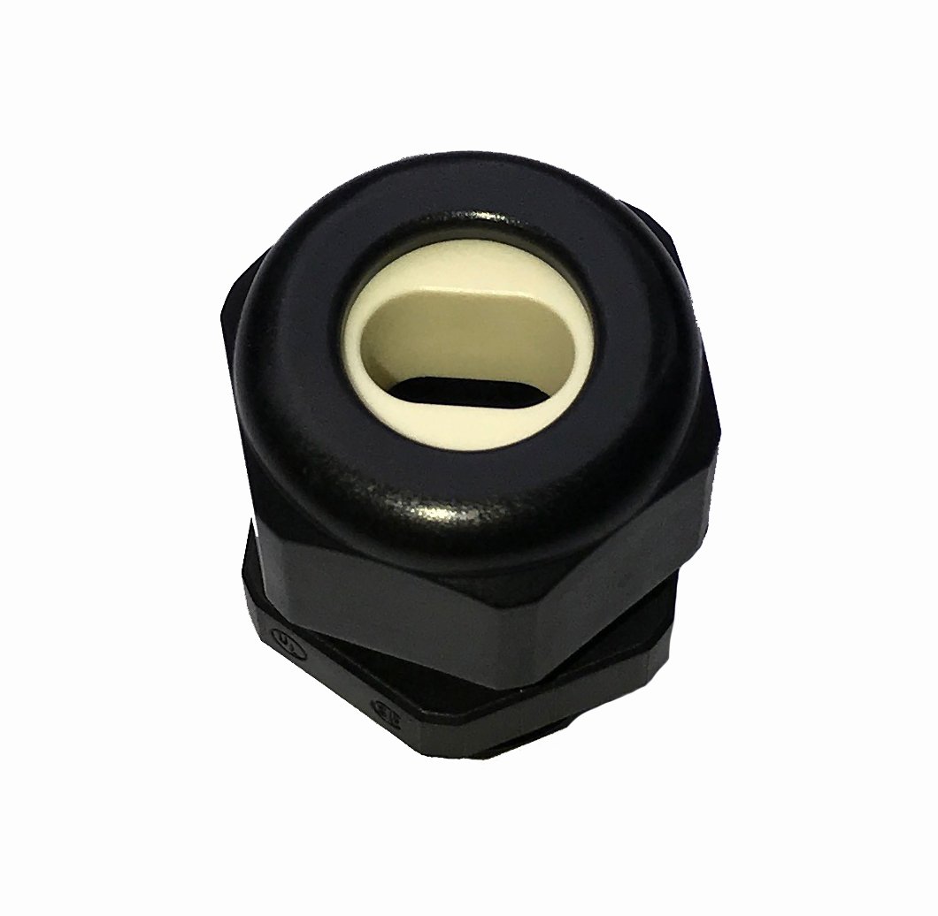

I want to mount this box on the outside of the house and come into it through the back hole with romex from inside the house, and then change to stranded THHN to be run in PVC conduit outdoors.
I am under the impression that I need a connector on the romex to secure it to the back of the box in the hole where it enters the box. My question is what type of connector do I use for this purpose?
According to the code, any connector that has metal in it must be grounded. So I am looking for a non-metallic connector for romex that will fit/work with a PVC box. If I screw in a metal connector, it must be grounded and I am not sure how to ground it within the rules of the code, so I would prefer no metal in the connector.
250.4(A)(2) Grounding of Electrical Equipment. Normally non-current-carrying conductive materials enclosing electrical conductors or equipment, or forming part of such equipment, shall be connected to earth so as to limit the voltage to ground on these materials.
It would seem to me that there ought to be many non-metallic romex connectors for going into a PVC box, but I can't find any for that purpose. I feel I must be missing the obvious, but can't find it.
Basically my question is very simple: How do you properly connect romex to a PVC box? (The key word is "connect.")

I think a connector would be like an outlet. To ground the box, get a metal box. Those come in metal too. I think aluminum, but I am not sure what the common metal is. That box you pictured is not conductive.
The threads match rigid conduit, which is threaded the same as NPT water pipe.
A PVC box is not conductive materials.
mincam
11
Any metal in the connector is conductive and it encloses the conductors.
In any case it is irrelevant to my question which is how do you connect romex to a weatherproof PVC box?
Any relevant reply will be only about connectors.

The isolated metal NM connector on a PVC box is definitely a corner case as far as 250.4(A) goes. It is arguably small enough to be ignored. If you used a metal cable tie to secure NM cable, or use a two hole metal strap on a metal surface, I don't think anyone would expect those to be bonded. Likewise for a PVC male adapter or liquidtight connection to a plastic enclosure hole, using a metal locknut to secure the male adapter. These otherwise all plastic connector often come with a metal locknut.
But if you absolutely want to avoid metal for some reason, it looks like you could use an all plastic strain relief cable connector, with an oval hole for NM or UF cable. Something like this, although I don't know if the size is right:
https://www.amazon.com/Liquid-Tight-Strain-Relief-Cord/dp/B06Y2J7N6K

The grounding of the connector only applies in 1-1/2 connector or larger.
Very interesting, and I am not doubting you. However, please cite the section of the code that specifies 1-1/2 or larger. I need to be able to back your claim up. Thanks.
Cheers, Wayne
"It is arguably small enough to be ignored" does not satisfy prohibiting ungrounded "conductive materials enclosing electrical conductors ," although I agree that it is being incredibly picky in this case.
But,
BINGO!!!!
You win the prize with the plastic lock nut, thank you so much.
Actually, I think the prize goes to the practitioner who realizes this is not the place to be "incredibly picky." : - ) But I agree, if you came up on an incredibly picky inspector you couldn't budge, go for the plastic cable gland.
