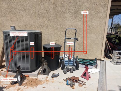

I have a 3" ABS clean out on the side of my house and I wanted to see if it was possible to repurpose this as a tie in for an outdoor bathroom for our pool.
It currently has a threaded cap (that isn't glued in, I broke out a small amount of concrete around to investigate) so my thinking was that I could remove the threaded cap, add a wye and put the threaded cap on the top of the wye. (effectively extending the cleanout?)
I would then use the new wye inlet as the tie in for the outdoor restroom.
To ease installation of all this the plumbing will be above grade and I will build the bathroom on block piers.
The goal is to put in a shower, toilet and a sink.
Pics to aid the imagination:
P.S. I know it's not vented to code, the fixtures are there just to aid the imagination. I'm mainly concerned about the tie in at this stage.
