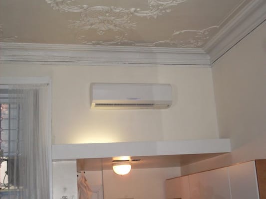

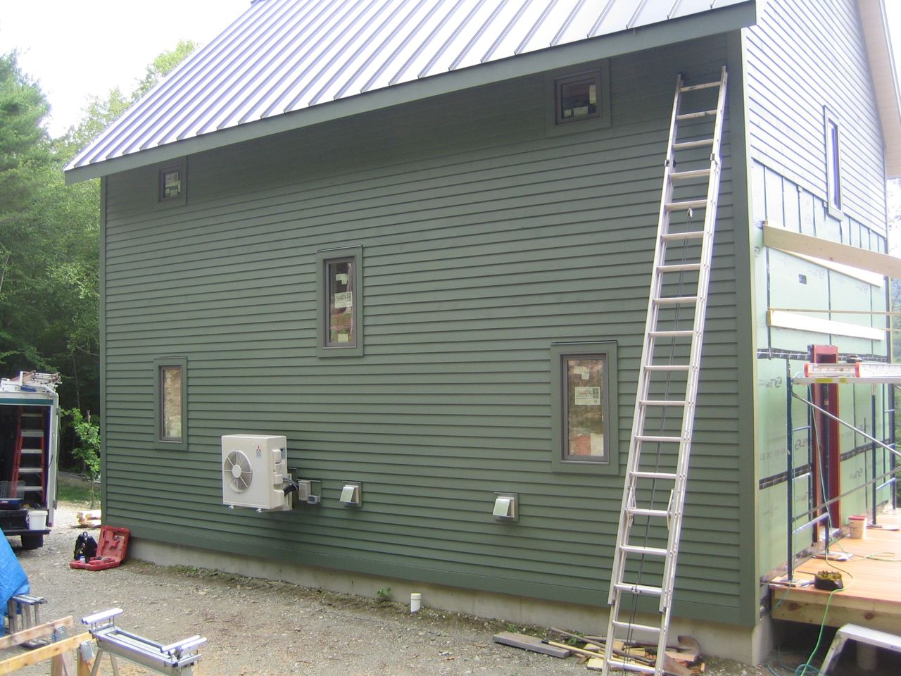

The interior head of a mini-split is typically 20-36" wide, 12-15" high, and projects into the room 9-12". A thing of beauty they're not, but there are flush-mount ceiling units that look like an oversized air-register (but for more money than a wall unit.) But even the wall units are no uglier than a window-mounted room air conditioners, and if you get a good one (SEER > 16, HSPF > 9) it'll be ~2x as efficient as a window mounted AC. The outdoor unit with the compressor looks like an oversized box fan, but they're much quieter than the traditional air-conditioning cube's we're all used to seeing.
outdoor unit- probably a 2 or 2.5 ton
typical indoor head
Bracket mounted above peak wintertime snow depth, protected under eaves.
