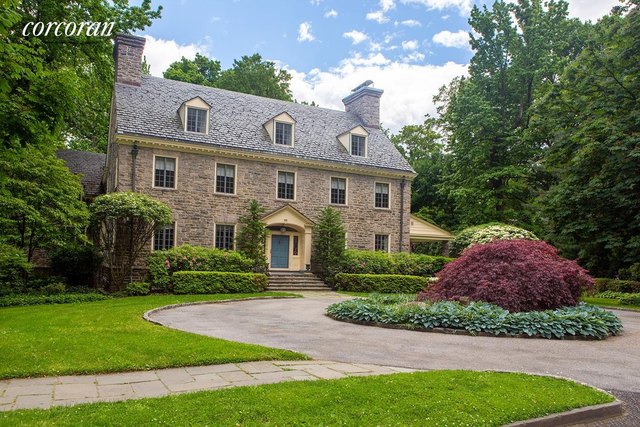

For example when I first started out I used to offer a discount for a yearly cleaning of all the leader lines and yard drains and main sewer being snaked and the main house trap cleaned (WET DRY or Laddle)
What I did was schedule several jobs a day for October and November for jetting and snaking because of the fall season and leaves blocking lines
Each call is a minimum of $750 and on average it takes one man less than an hour
I had two accounts around the corner from each other and I charged by the leader /floor/yard/area drains $125 each
One lady has 23 drains and it took me almost 4 hours and the other account had 18 drains and took about 3 hours ...7 hour day $5,125 per day and I have 30+ houses not to mention old age homes and the commercial accounts
Because I was doing it once a year the actual jetting of each drain was normally less than 15 minutes the set it took most of the time
The first time I did it took over an hr a drain as this house never had routine drain cleaning and has a total of 23 leader lines and it belonged to the Gambles (Procter and Gamble) below
The reason I was able to convince them to do it yearly is their copper leader lines were blocked and split open from a freeze-up Behind the bushes I installed cleanout Tee's to law easier access to the storm lines
I told them to call a roofer I know to clear the gutters and the next day I would do the leader lines or I would show up the same time the roofer was there and he would pass my hoses down the leader lines
Look how easy it would be to run a Jetter hose or 3/4" cable in either direction
