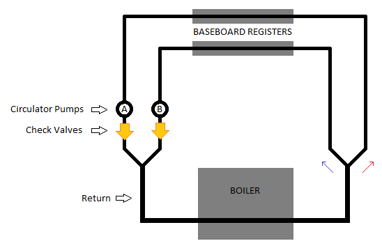

In a system with a circulator pump for each zone, do we also need zone valves, or will the pumps themselves block water from flowing through them when they are "off"?
For example, say there are 2 pumps:
  • Zone A pump.
  • Zone B pump.
  • (And no valves)
If Zone A pump is running and Zone B pump is not running, will water be pushed into Zone B anyway?
See diagram... Will water only go into Zone A (red arrow), or will some water also go into Zone B (blue arrow)?

If pump A is pumping toward the boiler it will be depressurizing the wye at the right side of the diagram, and pressurizing the wye at the left. That will force flow back through pump B toward the right side. If the pumping head of the boiler is an order of magnitude lower than the B-pump branch that may not matter very much- pump B will spin very slowly in reverse, and the flow will be quite limited. If it's a higher head boiler there could be enough flow for measurable amounts of heat to be emitted from the B-zone baseboard.
With check valves at the outputs of the pumps (recommended) that doesn't happen. Many pumps come with integrated check valves that can either be installed or not, depending on the applications. Most of Taco's circulators pumps almost always come the "IFC" check valve, but many hacks wrenching on hydronic systems seem to toss 'em out. If it turns out you need one they are sold separately, and are cheaper than a check valve as a completely separate component.

Dana, thank you for the thoughtful response. So to make sure I understand you, I updated the diagram to include check valves.
With check valves installed now, water can't travel backwards through pump B. But I still have a question about the wye on the right side of the diagram. Could water still push into the B side of the wye (blue arrow) even if pump B is "off"?
I guess the core of my question is whether an unpowered circulator pump can act as a "closed valve", thereby eliminating the need to have traditional zone valves.

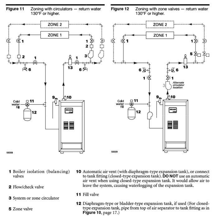

FWIW- many modern boiler manufacturers recommend "pumping away" from the boiler, ie the pumps should be on the right side of your diagram. Check the install manual for your particular boiler to be sure as some still pump to the boiler.

NY_Rob: Most modern boilers aren't anything like that cast iron dinosaur in the diagram. Water tube mod-cons have somewhat higher head, and you're better off pumping TOWARD the boiler. Pumping toward the boiler makes it the highest pressure location on the loop, reducing any propensity for flash-boil/kettling in the heat exchanger. Placing the expansion tank near the intake side of the pump acts a bit like a shock absorber, reducing cavitation wear on the impeller, and minimizes pressure pump cavitation vibrations from pulling air into the system from system vents.
Pumping away from the expansion tank is the most important aspect. With old-school cast iron like that with a pre-plumbed port dedicated to the expansion tank, pumping away from the boiler was the same as pumping away from the expansion tank.
Cheesecakelover: In the new diagram the pressure difference at pump B is still in the reverse direction when pump A is running. A pump is not a closed valve- when unpowered the impeller spins freely in either direction when there is a pressure difference across the pump. With a pump on each zone there is no need for a zone valve, just a check valve will do. Zone valves are for limiting the number of pump$, and reducing overall electricity use in the system.

Dana, sorry I don't understand. With a check valve shielding pump B from backward flow, how can there be reverse pressure at pump B?
In addition, you mention that when unpowered the pump impeller spins freely, therefore an unpowered pump does not block water. Yet you also said that no zone valves are needed if you have a pump on each zone? I can't rectify these seemingly contradicting points in my head because if the unpowered pumps don't block the water, what is preventing hot water from entering a zone other than the one it is intended for? Please help me understand.
Perhaps we're getting hung up on semantics. The reverse pressure is blocked by the check valve, so there is no reverse flow. But that is the direction of the pressure differential.
Water doesn't move until and unless something is creating a pressure difference. If reverse flows are being blocked by check valves on every zone, and there is no reverse pressure or flow at the pump, and there is no pressure in the positive direction being induced. The water in the off zone just sits there- it can't be sucked out at the wye at the right side of the diagram with the check valve at pump B, but if that valve were absent it would backflow on the pressures induced by pump A. The pump doesn't block the flow, the check valve does.
In some messy primary/secondary systems there can sometimes be a slight forward pressure on "off" zones induced by the primary pump, enough to spin the pump in the forward direction, but only rarely to the point of needing a zone valve.
Got it, thanks. Yeah this part I understood.
I think what you wrote here really zeroed in on my question. So basically what I'm taking away (and please correct me if I'm still getting this wrong) is...
  1. An inactive circulator pump does not block water, so water could flow through it, in whatever direction the pressure drives the flow.
  2. In this case, if Pump A is "on" and Pump B is "off":
    • Pump A creates a high-pressure area in front of it (orange). Some of this water would flow backward through Pump B, but cannot do so because the Pump B is protected by a check valve. Therefore all the water must flow through the boiler.
    • Simultaneously, Pump A also creates a low-pressure area behind it (blue). Therefore water after the boiler will flow into this low-pressure area (following the green arrow) in order to equalize.
    • The water in the B loop (black) would want to flow into the low-pressure (blue) area (following the black arrow), but it cannot do so because check valve B won't allow any water to take its place.
