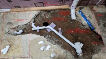

MikeGA
52
North Jersey
Does this explain what I'm trying to accomplish?
The red text over the soil is too small to read, other than the part about the 30" vanity.
But based on the layout, and assuming you don't plan a wall between the WC and shower (you could have a partial wall, it would just take up more thickness than only glass), then the options I see are shown in blue and green. Two different options, pipe size is not shown, but the shower drain is 2" and the WC drain is 3", with the vent 2" or 1-1/2" depending on your plumbing code. NJ uses the NSPC, which is different from the IPC and UPC, so I forget what size they require for a WC vent. The shower wet vents the WC.
The lav would need its only dry vent takeoff, and then both dry vents need to ultimately go to the roof. They can tie into existing dry vents, at least 6" above the flood rim of all the associated fixtures. Or if NJ allows AAV you could use 1 or 2 AAVs for venting.
Cheers, Wayne
Black Circle =Closet flange for toilet (12.5” off stud & 15” off end of shower pan)
4" Main Drain = This isn't a vent that goes through the roof, it ties into the toilet from upstairs, which has a separate dry vent that I will tie into.
