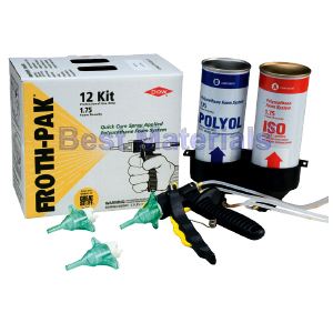

The bottom side of the cantilever never gets direct wetting from rain or dew, so as long as it's air-tight to the interior the moisture accumulation risk is pretty low. Blown cellulose would share that moisture burden with the wood, but renting a blower @ ~$100/day for such a tiny space seems a bit silly.
For under $50 you can get a 12 board foot Froth-Pak kit (sometimes at the Home Depot / Lowes type places, but always online), a couple of inches of which would be more than sufficient for dew point control. The foam gun that comes with it is pretty small, and should fit pretty much any place you can get your fist into.
That's enough foam to cover 6 square feet with 2", or 6 square feet of 1" with enough left over to do quite a bit of air sealing as well. If you can get enough line-of sight to see where it's going, covering & air sealing the subfloor with even an inch of foam would be sufficient to prevent air infiltration though seams & penetrations of the subfloor and lower the vapor permeance enough to limit moisture diffusion to tiny levels.
For filling the cavity carefully cut up & stuff blocks of rock wool batt for a compression fit, no voids, followed by a vapor retardent interior side air barrier to block air infiltration to/from the basement. Cut-up XPS sealed at the edges with can foam or Froth-Pak is fine to use as the air barrier/vapor retarder.
